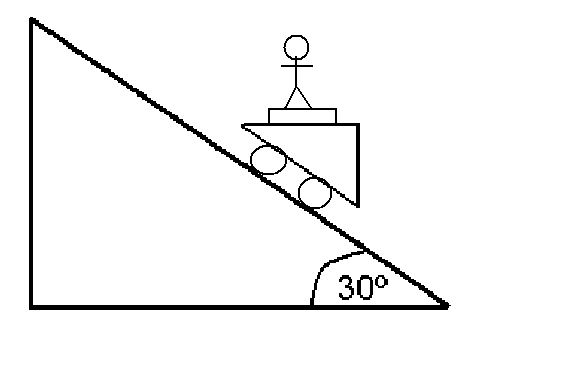

Julie tightened herself fastened a set of bathroom spring scales to a platform and went down a 30 degree slope. No friction was present and the platform supporting the scales was HORIZONTAL. what fraction of her true weight was indicated by the scales?
so what i did was just assume a random mass, in this case 50kg so that means around 500 Newtons.
Therefore, Fnormal would be 500 cosine 30 = 433 Newtons
than all i did was take 433 and divide it by 500 which gives me 0.866. So is it right to say that 87% of her true weight will be shown on the scale?

That is not correct. The normal force you have calculated is the force of the plane on the wheels , acting perpendicular to the incline. And that would be the scale force indication if the scale was also parallel to the inclined slope. But it is given that the scale platform is horizontal. You've got to look at the forces acting on the person in the vertical and horizontal directions. Is there acceleration in the vertical direction?

No, that would be true only if the net force in the vertical direction was 0 (no acceleration in the vertical direction). But there is acceleration in the vertical direction, because the person is moving vertically downward at increasing velocity due to a net force downward in that vertical direction. The person is also accelerating horizontally, because he/she is also moving horizontally at increasing speed. Note further that the person's resultant acceleration is parallel to the slope, so you might want to find the acceleration of the platform and person and scale down the plane in the usual manner you are accustomed to for forces acting parallel to the plane. Then find the vertical component of that acceleration and use Newton 2 in the vertical direction.

No, the vertical component of the acceleration, ay, comes from the trig... ay/ap = ___?___ (it is not the cos function, draw a sketch)...

Yes, her downward acceleration is 2.45 m/s^2, very good. Her weight is just mg or 98N if you assume m = 10 kg. Her apparent weight is the scale reading, or the normal force acting perpendicular to the scale. You actually had the correct answer in your post #9, (but your input values were slightly off... ). Using Newton 2 in the vert direction as per azizlw post #11, you get the answer for N. If you had not assumed a mass and instead used her mass as m, you get the normal force directly as a fraction of her weight.

Wait to solve for the fraction of the true weight, would i take acceleration in the y (2.4525m/s^2) and subtract it from gravity so 9.81 - 2.4525 = 7.3575m/s^2 and than multiply that by 10 which gives me [strike]72.2[/strike] 73.575[/color] Newtons. And than would i take [strike]9.81[/strike]10[/color] x 9.81 = [strike]96.2361[/strike]98.1[/color] Newtons and than divide [strike]72.2/96.2361 = roughly[/strike]73.575/98.1 = exactly[/color] 3/4 her true weight[strike]?[/strike].[/color]
Now without putting any value to m
The ratio= N/mg= (Mg-Ma)/Mg= (g-a)/g
a=gsin30°sin30°
N/mg= (g-g(1/2)(1/2) )/g= 1-1/4= 3/4
\frac {N}{mg}=\frac {g- g.\frac{1}{2}.\frac{1}{2}} {g}=1-\frac{1}{4}=\frac {3}{4}
