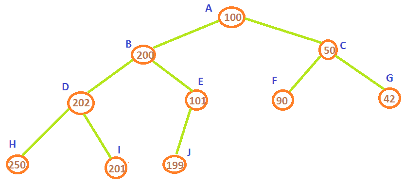

Suppose that we have this tree:
and we want to apply the following algorithm:
Code:
Procedure Pr(pointer P){
   if (P==NULL) return;
   Pr(P->lc);
   print(P->data);
   Pr(P->rc);
We call the procedures [m]Pr(A), Pr(B), Pr(D), Pr(H), Pr(NULL)[/m], right?
When we run the Procedure [m]Pr(NULL)[/m], the command [m]return;[/m] is executed.
After that, what do we have to do? Do we have to execute the commands, that are under the command [m]Pr(P->lc);[/m] for [m]P->lc=H[/m] ? (Thinking)
I don't know; is it part of the problem statement to make all these calls, and then predict what the outcome will be?
Right.
I don't know; what is the exact problem statement?
When the code gets to the point where it is at H, it will call [m]Pr(H->lc)[/m]; however, that will be a null pointer, so it will return without executing the remainder of the commands in [m]Pr[/m]. Does that answer your question?

The algorithm should traverse the tree, so that the keys will be printed in ascending order.
I wasn't sure what command the algorithm will execute, after executing the command return; .. (Thinking)
Ok: in your mind, is G the right-most node (is it the right child or left child of C)? Because if it's the right child, and you need to print in ascending order, then you should process right child, node, then left child - the opposite of the order you have.
When the return is executed, then that call of [m]Pr[/m] is done executing, and will leave the stack, and you'll go back to the parent's instance of [m]Pr[/m].
Oh yes, you are right! (Blush) So, should it be like that?

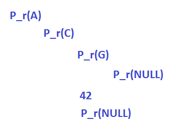

So, the procedures [m]Pr(A),Pr(C),Pr(G),Pr(NULL)[/m] will be executed, then the number 42 will be printed. Then, the procedure [m] Pr(NULL)[/m] will be called and the command return; will be executed, right? (Thinking)
Exactly right. Now the [m]G[/m] node has been fully processed, and the [m]Pr(G)[/m] call to the function will finish executing. Then the program gets rid of that instance of [m]Pr[/m] from the stack, and continues executing the [m]Pr(C)[/m] instance. It's finished the right child, so now it does what?
Ackbach said:
Yes, at least that's correct in pseudocode. The exact syntax you'll need to make work in whatever language you're using.
We will have something like that, right?
After that, why do we execute the commands [m] print(C->data)[/m] and [m]Pr(C->lc)[/m]?
If there were also other commands, after the command [m]Pr(P->lc)[/m], would they be executed for G or would the [m]G[/m] node be again fully processed? (Thinking)
