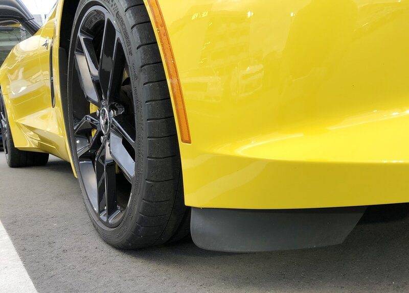

What is aerodynamics function of front active lip spoiler?
20 replies · 6K views · last reply
Jurgen M
This is question for aerodynamicist, so I put it here in aerospace department.
(Mechanical engineers don't learn aerodynamics at university)
What is aerodynamic function of active front lip spoiler (on video) and what is function of flexibile plate infront of front tyers(picture)?
Why reduce amount of air that goes under the car?

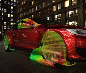

Exposed rotating tires are one of the worst parts of drag. Covering them up as much as possible reduces drag. The little spoiler in front of them diverts the airflow from the tires.
https://www.teslarati.com/digital-wind-tunnel-tech-behind-tesla-model-s-aerodynamics/ said:
Mirrors and wheels can account for as much as a 25% increase in aerodynamic drag​
According to Tesla rear-view mirrors are said to increase aerodynamic drag between 3 to 6 percent. Palin goes on to say that wheels can generate an additional 20% of drag as seen in the following flow field diagram from Exa’s PowerFLOW software.
Red sports car on a city street at night, with colored airflow streamlines wrapping around its front wheel arch and spoke, visualizing airflow around the wheel.
Areas marked in red indicate the highest areas of drag. (Image credit: SAE.org)
“One of the objectives with the Model S was to minimize the airflow around the front wheels and to line up the airflow so it hits the front wheels head on. We needed to avoid air hitting at an angle, as often the side of the tire acts like a bucket that catches the air, producing significant drag. This was an area where we made a huge improvement from the initial concept designs to the final design.”, said Palin.

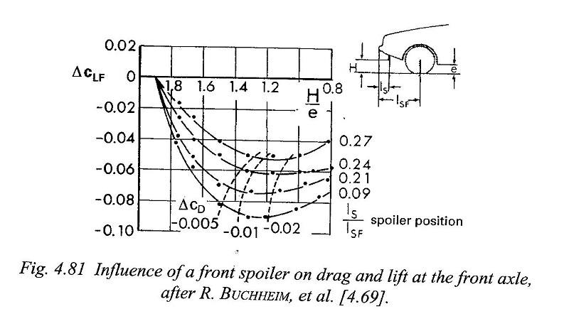

Two reasons - reducing aerodynamic drag and reducing aerodynamic lift. Reducing drag is important if you are interested in either gas mileage or top speed. Reducing lift is important if you want the vehicle to stay on the road at high speed. Both are affected by the front spoiler, also known as an air dam. An excellent source for detailed information is Aerodynamics of Road Vehicles, Fourth Edition, by Wolf-Heinrich Hucho: https://www.amazon.com/dp/0768000297/?tag=pfamazon01-20. It has 918 pages of more than you ever wanted to know about the subject. A sample plot from page 190 in the section on front spoilers:
Graph of change in front-axle lift coefficient against H/e for a front spoiler, with curves labelled by spoiler position Is/ISF and drag change markers, and a small side-view car diagram showing H, Is, ISF and e.

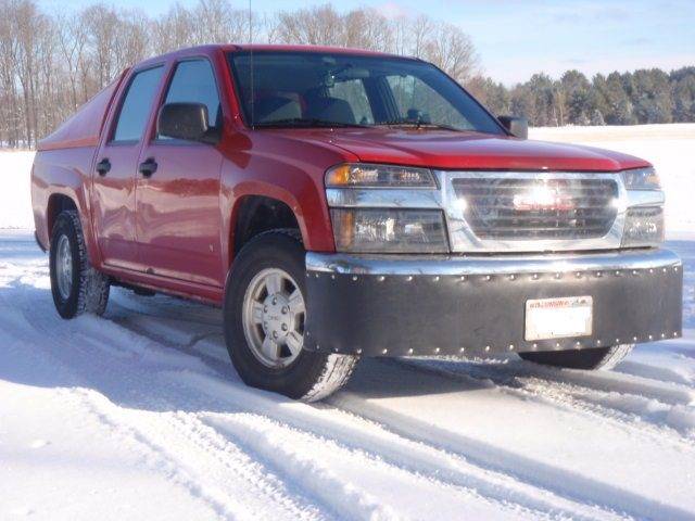

There is a group of people who are not satisfied with vehicles as designed by the manufacturer, so we modify them. Photo of a truck with a modified front spoiler, grille block, and aerodynamic topper:
Red GMC Canyon pickup truck with a dark add-on front bumper lip, parked on snow-covered ground with tire tracks.
If you are curious about the effect of these, and other, modifications on the gas mileage, here's the thread: https://ecomodder.com/forum/showthread.php/modding-06-gmc-canyon-17070.html.

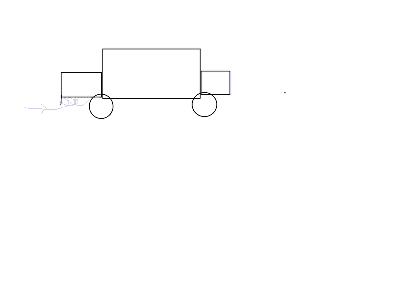

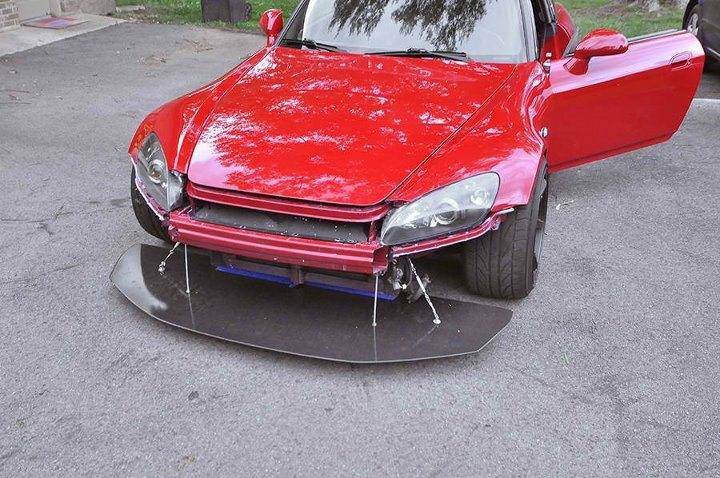

I don't understand how this simple vertical spoiler reduce drag or reduce lift,because it is just flat vertical plate,there is no flat undertray behind,like on race car that have horizontal front spoiler like on pcture below.
Do you know how it works?
This vertical plate must produce flow separation behind ..
Simple side-view line sketch of a car: a large central rectangle for the body, two circular wheels, and two small rectangles at the front and rear, with a faint wavy airflow line at the left.
Horizontal flat make sense to produce downforce using high stagnation pressure above .
Red Honda S2000 viewed from the front-left with its driver door open, fitted with a black flat front splitter attached by thin cables beneath the bumper.

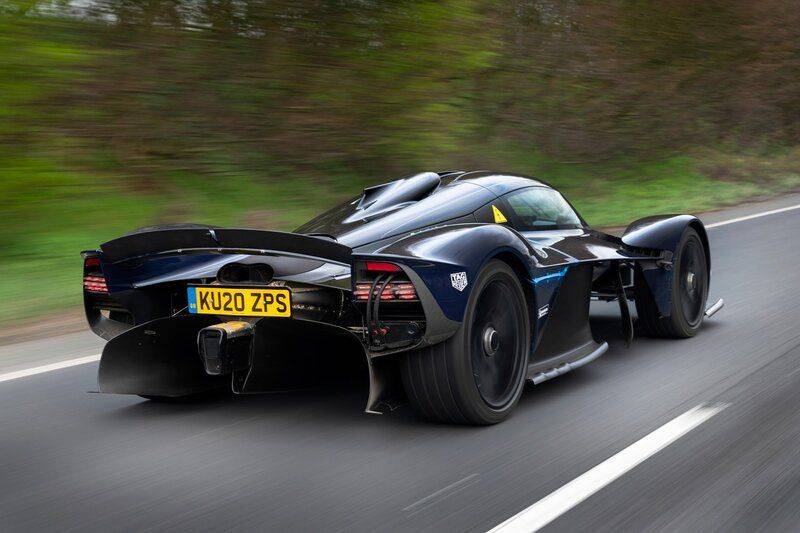

Not completely true, point is in air speed(acceleration).

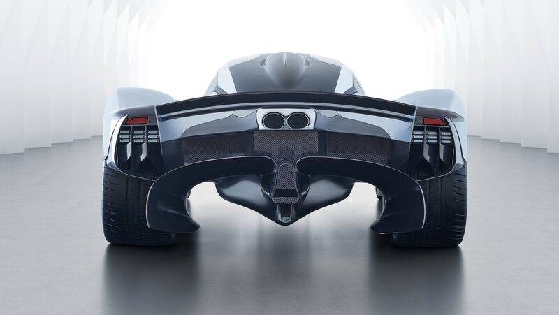

You can sleep under this car and has downforce in tons.
Rear view of a dark grey supercar on a pale studio backdrop, showing a large rear wing, twin exhaust outlets, a carbon-fibre diffuser and a wide central rear section between two tyres.
Rear three-quarter view of a dark blue hypercar with a large fixed rear wing, a central exhaust outlet and a yellow UK registration plate reading KU20 ZPS, driving on a road with a blurred green background.
Jurgen M said:
You can sleep under this car.

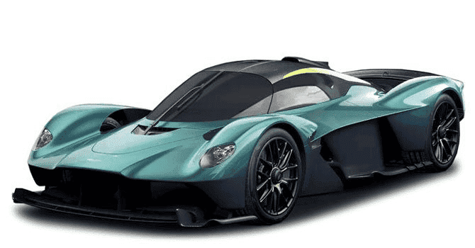

The front has a flap which increases downforce. Enough that any air that escapes under the car doesn't produce much lift:
Front three-quarter view of a teal-green supercar with a black roof panel, black wheels and a dark front splitter lip beneath the nose.
What's actually bothering you?
Wrong, 80% of downforce produce tunnels.
  • Skeptical

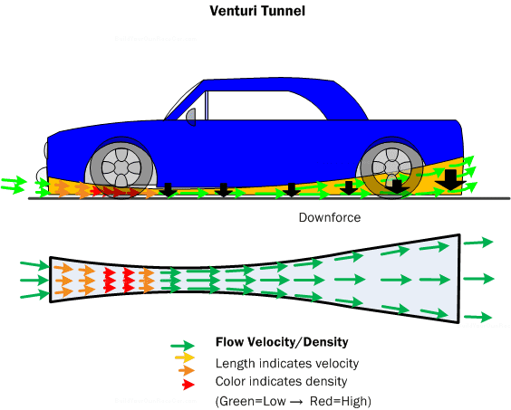

There are 2 ways to look at the airflow under a vehicle. The designs you are showing in posts #6 & #7 will create a low-pressure zone by using a venturi effect. This usually requires careful design of the underbody:
https://www.buildyourownracecar.com/race-car-aerodynamics-basics-and-design/4/ said:
Venturi Tunnels​
Venturi tunnels, much the like a venturi tube observed in a laboratory, use the constriction of a flow to generate high speed, low air pressure areas under the race car. In diagram AD8 below, we show a car with a venturi tunnel, and below that a similar venturi tube you might see in a lab.
Diagram titled Venturi Tunnel: a blue car in side view with downward black arrows under it labelled Downforce, and below it a converging-diverging duct with green, orange and red flow arrows showing velocity and density.
Diagram AD8. The Venturi tunnel shape increases the velocity of the mass of air flowing through it, lowering the pressure and generating downforce.​
On race vehicles, the venturi is usually formed by making the undertray of the vehicle shaped like an inverted wing. The distance between the undertray and the road forms a constriction and then expands to enable the low pressure created by the constriction to act along the middle and rear and of the vehicle. Venturis are very efficient devices but are susceptible to changes in vehicle ride height.
Having the front horizontal plate will set the low-pressure zone more towards the front of the vehicle, therefore being able to adjust the front/rear distribution of the downforce.
With the simple vertical plate, there might be turbulence, but there is also a low-pressure zone. On the plus side, the design is a lot less complicated:

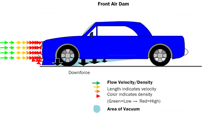

https://www.buildyourownracecar.com/race-car-aerodynamics-basics-and-design/3/ said:
Front Air Dam​
A Front air dam is used to prevent air from flowing underneath a vehicle. It does this by creating a “dam” or wall across the front of the vehicle that extends close down to the road and usually along the sides to some extent. This creates an area of vacuum or low pressure underneath the car as shown in diagram AD4 below. This low pressure area, in combination with the higher pressures above the front and top of the vehicle, generates downforce at the front of the vehicle.
Diagram of a blue car in side view showing airflow from the left: green, yellow, orange and red arrows indicate velocity and density, with downward arrows under the front labelled Downforce and a light blue area of vacuum beneath the car.
Diagram AD4. The front air dam blocks air from going under the vehicle. This creates a low pressure area immediately behind the air dam. Which provides downforce. However, without side skirts, air soon enters from the sides to equalize the pressure underneath the car which diminishes downforce further back.​
If we extend the air dam along the sides of the vehicle to become “skirts”, we can extend the vacuum or low pressure area generated under the vehicle by the air dam as well.
Reducing the ground clearance will help you reduce the underbody pressure just like a front air dam does. Lowering it more at the front axle than at the rear axle will get you closer to a venturi tunnel design.

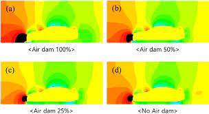

How drag is reduced if we can see (and expect) that air dam will increase pressure at front part of car plus will add higly turbulent airflow behind dam?
Any forward faceing plate will add more drag,I mean this is pure logic.
Four CFD pressure contour plots of a car's front end labelled (a) Air dam 100%, (b) Air dam 50%, (c) Air dam 25%, (d) No Air dam, with colour bands showing airflow pressure around the front.
russ_watters said:
No, the goal is to reduce pressure/lift. There's more than one way to do that.
Obviusly this is very bad way to make downforce, there is no any raceing car in the world that use this "blockage way" to produce downforce.
Any forward faceing plate will add more drag,I mean this is pure logic.View attachment 312961
Where did you get those photos? What is the car that's being modeled there? The photos are so small it is hard to see the shape of the air dam. Anyway, the logic has already been explained, but you didn't respond to it so it isn't clear to me that you saw it. The drag from an open grill isn't at the grill it's inside the engine compartment. And the drag from air flowing under the car is from obstructions under the car and from the road. It isn't at all clear to me if those are being modeled in those photos.
And again, it's highly dependent on the specifics of the modification if it will increase or decrease drag while increasing downforce/decreasing lift.

Btw, I don't think anyone answered this:
It's part of the air dam, but is flexible so you don't damage it if the front of the car bottoms-out.

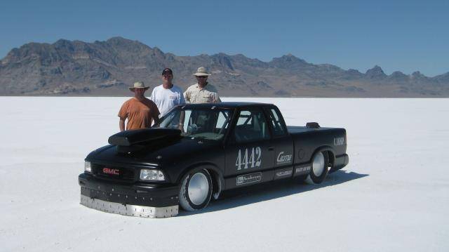

People at Bonneville all do it this way and their only goal is to go as fast as possible!
Red Chevrolet Camaro-bodied race car with a large black front air dam and rear wing, racing across white salt flats with spectators and motorhomes behind it.
Black GMC pickup truck with number 4442 on its doors, a large front air dam and a rear spoiler, parked on white salt flats with mountains behind it and three men standing at its front.
