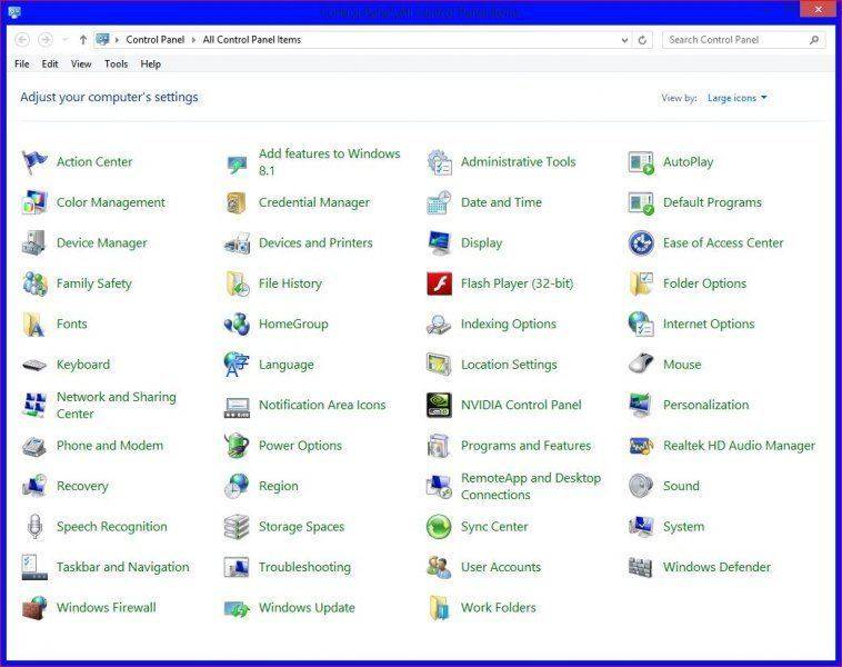

RaulTheUCSCSlug said:
Windows defender is awesome and I'm pretty sure it is free!
It should be included with 8.1... look in the Control Panel.

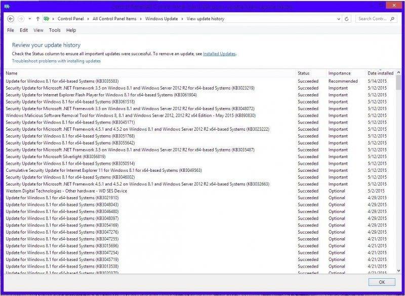

Are you installing "important and recommended" updates ?

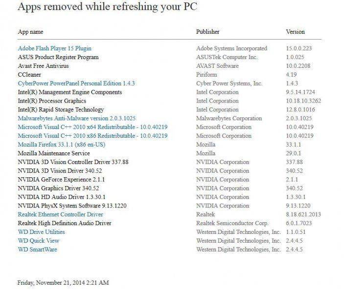

I did a simple "refresh", and ended up with:
A bunch of programs I had to reinstall... on a slow satellite internet connection. T'was a bummer... lol
