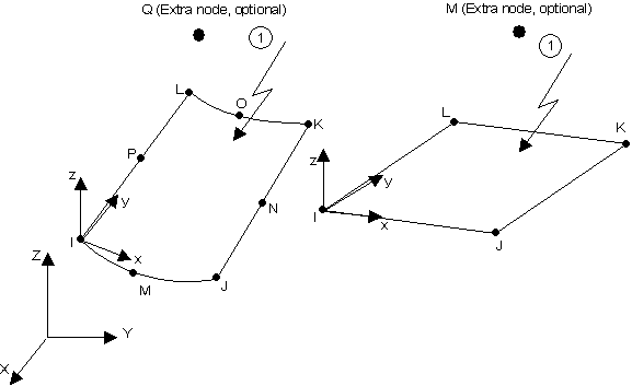

They're the only ones neceaary to describe any shape under the sun, especially when you take into account midside nodes which allow arbitrary shapes and quadratic interpolation. take for example this ANSYS element:
An element that was shaped like a dodecahedron would still be subject to the limitations of triangular elements, since it has faceted sides with discrete nodes; there is no advantage to using a huge element with a million faces when you can use a million elements with single faces.
