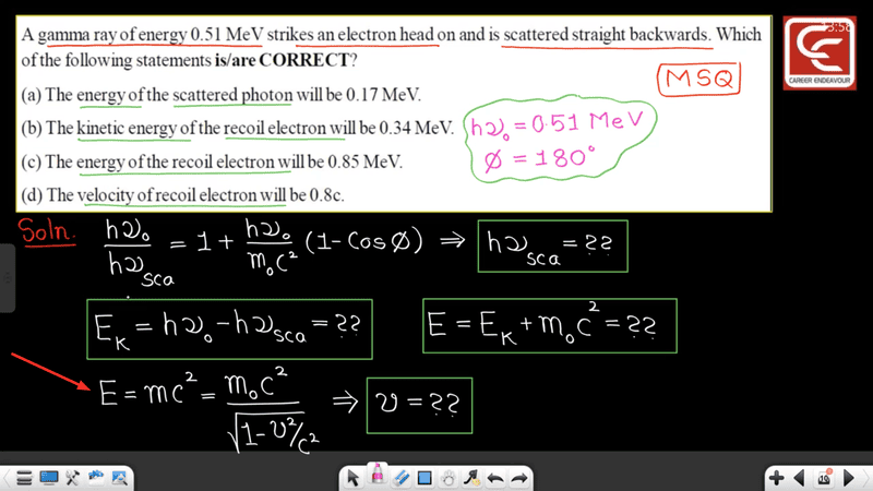

Dale said:
Nowhere. There is nowhere that you should use relativistic mass.Everywhere. You should avoid using relativistic mass everywhere.No. The ##m## in ##E=mc^2## is the invariant mass since the formula only applies to systems at rest anyway. Although it is super-famous, ##E=m c^2## is not a very general expression. The general expression is $$ m^2 c^2 = E^2/c^2 - p^2$$ The famous equation is the special case of the general equation for ##p=0##.
So, the famous equation is only true when the momentum of the system is 0. Thus the ##m## in the famous equation is the invariant or "rest" mass. This ##m## is also the ##m## that you find in tables listing the properties of particles, the ##m## that you use in the relativistic version of Newton's 2nd law, and the ##m## that you measure with a balance scale.
hey, thank god you had commented this, btw, my professor used ##E = mc^2## to calculate the velocity of a moving electron instead of the general expression ## m^2 c^2 = E^2/c^2 - p^2##, so is he wrong here? Third line (I mean, I think he is wrong, but he is my tutor, so, I sought your help
edit: The kinetic energy of the electron is 0.34 MeV and thus the total energy will be 0.51MeV+0.34MeV = 0.85 MeVSo, I would say ##({(0.85Mev)}^2 = (mc^2)^2 + (pc)^2## and not the special case
Yes and no. If he means relativistic mass by ##m## (which he apparently does) then his expression is correct - it's just that any use of relativistic mass is horribly open to misinterpretation and confusion. It's correct here because (for a particle of non-zero mass)$$\begin{eqnarray*}
E^2&=&m_0^2c^4+p^2c^2\\
&=&m_0^2c^4+\gamma^2m_0^2v^2c^2\\
&=&m_0^2c^2\left(c^2+\gamma^2v^2\right)\\
&=&m_0^2c^2\left(c^2+\frac{v^2}{1-v^2/c^2}\right)\\
&=&m_0^2c^2\left(\frac{c^2}{1-v^2/c^2}\right)\\
&=&\gamma^2m_0^2c^4
\end{eqnarray*}$$So for things that have non-zero mass (i.e. anything not travelling at the speed of light) there's nothing mathematically wrong with using ##E=\gamma m_0c^2##. It's just a notational mess because you have to keep track of what ##m## means (and that only gets worse when you go beyond one dimensional motion because there are longitudinal and transverse relativistic masses that you need to use in different contexts). And it doesn't work at all for things like photons that have zero rest mass because they don't have a rest mass to start with so you have to have a special case explanation for what relativistic mass means in this case.
Much better not to use it.
If your course does use it (in any way other than mentioning that it exists and you have to keep in mind that some people mean ##\gamma m## when they write ##m##) then I would consider picking a different course. If that is not an option, any time the prof writes ##m##, you write ##\gamma m_0##. And as soon as you're out of the course, join the 21st century and drop the subscript zero.
Incidentally, this kind of collision problem is much easier to solve (in both Newtonian and relativistic mechanics) if you work in the zero momentum frame.
Ugh, that is a bad sign. It means the professor is decades out of date with their source material. I would solve this using the four-momentum as follows
The four momentum is ##P=(E/c,p_x,p_y,p_z)##, for convenience I will use units where ##c=1## and ##m##, ##E##, and ##p## are all measured in ##\mathrm{MeV}##. We can ignore ##y## and ##z## here, so I will just drop those. The four-momentum is conserved, so setting the four-momentum before the scattering equal to the four-momentum after the scattering we get $$P_{photon,before} + P_{electron,before}=P_{photon,after}+P_{electron,after}$$$$(0.51,0.51) + (0.51,0.00) = (E_{photon,after},p_{photon,after}) + (E_{electron,after},p_{electron,after})$$ This gives us two equations in four unknowns, so we use the general equation ##m^2=E^2-p^2## to get two more equations $$0=E^2_{photon,after} - p^2_{photon,after}$$$$0.51^2=E^2_{electron,after}-p^2_{electron,after}$$
Solve to get $$E_{photon,after}=0.17$$$$p_{photon,after}=-0.17$$$$E_{electron,after}=0.85$$$$p_{electron,after}=0.68$$ and we can easily get the velocity of the electron with $$v_{electron,after}=\frac{p_{electron,after}}{E_{electron,after}}=0.8$$ and the kinetic energy of the electron with $$KE_{electron,after}=E_{electron,after}-m_{electron} = 0.34$$

Slimy0233 said:
hey, thank god you had commented this, btw, my professor used ##E=mc^2## to calculate the velocity of a moving electron instead of the general expression ##m^2c^2 =E^2/c^2-p^2## so is he wrong here? Third line (I mean, I think he is wrong, but he is my tutor, so, I sought your help
Not exactly wrong, because with a bit of algebra and an understanding of the four-momentum you can get from that more general frame-independent relationship to the frame-dependent ##E=\gamma mc^2## - and that is indeed the easiest way of calculating the total energy of a particle with known velocity. It's bad pedagogy though, because it tempts people to think of ##\gamma m## as a "mass" which it really isn't, and because in most realistic particle physics problems we know the momentum more accurately than the velocity.

Here's an energy-momentum diagram (energy upwards) that visualizes @Dale's calculation above
  • The numbers are nice enough to be drawn on "rotated graph paper"
    by taking 1 mass-diamond unit to be 0.17MeV
    so that the electron-mass is approximately 3 mass-diamonds (0.51 MeV).
  • The electron has initial 4-momentum OM.
  • The given incident photon has 4-momentum MZ.
  • The conservation of 4-momentum is [itex]OM+MZ = \stackrel{?}{ON}+\stackrel{?}{NZ}[/itex], where the state N is unknown.
  • As @Dale says, we need more relations to locate N.
    • ON is a timelike 4-momentum for the electron...
      so N lies on the "electron mass-shell", the hyperbola of radius 3 mass-diamonds centered at O.
      (fancy: The causal diamonds OM and ON have area [itex]3^2=9[/itex].)
    • NZ is a lightlike 4-momentum for the scattered photon.
      [so N lies on the hyperbola of radius 0 mass-diamonds centered at O].
      (fancy: The causal diamonds MZ and NZ have area 0.)
  • So, trace a (past-directed) lightlike ray from state Z until one intersects the mass-shell at state N.
    (M and N are the intersections of the two hyperbolas from O and Z, of radii 3 and 0, respectively.
    MN is the 4-impulse (the increment in 4-momentum) gained by the electron.)
  • Once you have located N, you can determine the 4-momenta of the final products.
    • ON has energy-component 5 mass-diamonds =(5*0.17MeV) and momentum-component 4 mass-diamonds =(4*0.17 MeV).
    • NZ has energy-component 1 mass-diamond =(0.17 MeV) and momentum-component -1 mass-diamond = -(0.17 MeV).
    • The velocities are gotten from the slopes of the 4-momenta.
    • The electron's final kinetic energy is the final energy-component minus the mass-energy = ((5-3)*0.17 MeV) [drawn in green].
