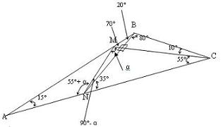

In the triangle ABC, we have $\angle ABC=100^\circ$, $\angle ACB=65^\circ$, $M\in AB$, $N\in AC$, $\angle MCB=55^\circ$ and $\angle NBC=80^\circ$. Find $\angle NMC$.

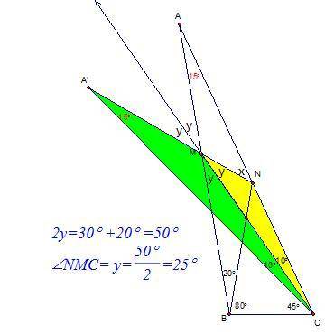

$ \angle A=15^o$
using MC as a mirror we got triangle A' MC as a symetric image of triangle AMC
then it is very easy to see that :
$ \angle NMC=25^o=\angle A+(65^o - 55^o)$
Albert said:
$ \angle A=15^o$
Hi Albert, I want to thank you for participating in this problem but your answer doesn't match mine.
Here is my solution:
First I let the angle NMC be $$\alpha$$.
Consider the triangle NPM,
$$\sin \alpha=\dfrac{NP}{MN}$$
Consider the triangle NCP,
$$\sin 55^{\circ}=\dfrac{NP}{CN}$$
$$\therefore NP=CN\sin 55^{\circ}$$
Now, since NP can be expressed as the function of CN, I will figure out a way to express MN in terms of CN because that is one of the valid method to find the measure of the angle $$\alpha$$.
Consider the triangle AMN,
$$\dfrac{MN}{\sin 15^{\circ}}=\dfrac{AM}{\sin (55+\alpha)^{\circ}}\implies$$ $$MN=\dfrac{AM\sin 15^{\circ}}{\sin (55+\alpha)^{\circ}}$$
But $$\dfrac{AM}{\sin 55^{\circ}}=\dfrac{CM}{\sin 15^{\circ}}$$ (from the triangle AMC)
and $$\dfrac{CM}{\sin 100^{\circ}}=\dfrac{BC}{\sin 70^{\circ}}$$ (from the triangle CMB)
Thus,
$$AM=\dfrac{CM\sin 55^{\circ}}{\sin 15^{\circ}}=\dfrac{BC\sin 100^{\circ}}{\sin 70^{\circ}}\cdot\dfrac{\sin 55^{\circ}}{\sin 15^{\circ}}$$ but $$\dfrac{BC}{\sin 35^{\circ}}=\dfrac{CN}{\sin 80^{\circ}}$$ (from the triangle BCN)
$$\therefore AM=\dfrac{CN\sin 35^{\circ}}{\sin 80^{\circ}}\cdot\dfrac{\sin 100^{\circ}}{\sin 70^{\circ}}\cdot\dfrac{\sin 55^{\circ}}{\sin 15^{\circ}}$$
or
$$MN=\dfrac{\sin 15^{\circ}\dfrac{CN\sin 35^{\circ}}{\sin 80^{\circ}}\cdot\dfrac{\sin 100^{\circ}}{\sin 70^{\circ}}\cdot\dfrac{\sin 55^{\circ}}{\sin 15^{\circ}}}{\sin (55+\alpha)^{\circ}}$$
We have now:
$$\sin \alpha=\dfrac{CN\sin 55^{\circ}}{\dfrac{\sin 15^{\circ}\dfrac{CN\sin 35^{\circ}}{\sin 80^{\circ}}\cdot\dfrac{\sin 100^{\circ}}{\sin 70^{\circ}}\cdot\dfrac{\sin 55^{\circ}}{\sin 15^{\circ}}}{\sin (55+\alpha)^{\circ}}}$$
Simplifying the above yields
$$\sin \alpha=2\cos35^{\circ}\sin (55+\alpha)^{\circ}$$
This gives$$\tan \alpha=\dfrac{2\cos35^{\circ}\sin55^{\circ}}{1-2\cos35^{\circ}\sin55^{\circ}}$$
Finally, we get $$\angle NMC=\alpha=87.4270^{\circ}$$
So Albert, who is right and who is wrong?:confused:
BTW, may I look at your diagram because I have a little hard time trying to figure out your solution, please?
Thanks.

anemone:
Your diagram is not correct ,please check it
note :angle MCB=$55^o$,
but your diagram angle MCB=$10^o$
do it again ,I will post my solution later
Albert said:
anemone:
Yes, you're right, I labeled the angle incorrectly:mad::o and by redoing the problem, I found that $$\angle NMB=25^{\circ}$$.
Your approach must be one of the smartest one because you solved it by observation but I approached it using lots of messy equations and therefore, my hat is off to you, Albert!:cool:(Wink)

yes before giving a short and smart solution ,I racked my brain,and spent much time thinking :)
