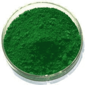

kindly clarify on the color of chromium ##cr^{3+}##. Is it green or grey-green? There is a conflict in my textbook i.e Roger Norris IGCSE Chemistry and the cie syllabus content 2019. regards,

Ans: Looks like both, depending for Cr2O3. See https://www.google.com/search?biw=1.....1...1..gws-wiz-img...35i39j0i67.EPzWGoCfhk4 .
242944
242945
I must have seen solutions of Cr+3 a couple of times and best that I remember, green; much like the color shown in post # 6, the picture on the left side.
Anhydrous chromium (III) chloride is purple. The color depends on the ligand field in addition to the metal center.
