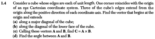

From Analytical Mechanics by Grant R. Fowles & George L. Cassiday.
Text of textbook problem 1.4: cube of unit edge length in an xyz coordinate system, with parts (a) through (d) asking for diagonal and face-diagonal vectors A and B, their cross product C, and the angle between A and B.
Only problem I am having is with part d.
##A\cdot B = A_xB_x+A_yB_y+A_zB_z##
##sin(\theta) = \frac{|A\times B|}{AB}##
Worked solution to problem 1.4 showing a unit cube on x, y, z axes with dashed edges, plus vectors A = i + j + k, B = i + j, and the cross product C = A x B as a 3x3 determinant.
I did it by hand but also ran the following Matlab script:
Matlab:
A = [1,1,1];
B = [1,1,0];
theta = acos(dot(A,B)/norm(A)/norm(B))
theta = asin(norm(cross(A,B))/norm(A)/norm(B))
Both formulas return 0.61548. I think the minus sign in part d should not be there, but I might be missing something. A second pair of eyes would be appreciated.
Where do you get the 1-1 in the numerator from?
(1*1)+(1*1)+(1*0)=1+1.
You can also use the result of (c) to get the angle.
(c) doesn't look like a final answer by the way.

The image is the solution from the manual. I used the Matlab code and got and angle of .6 in radians. It appears the solution manual was incorrect.
