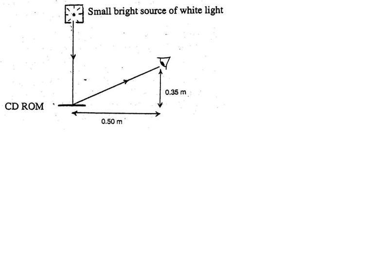

White light was shone vertically down on a cd tilted 5°, with adjacent tracks d = 720 nm. An observer some distance away observes a color of light. Determine that wavelength of light observed. (Refer to picture attachment)
finding path difference
I understand that finding the path difference is key to solving this problem. So, i found the path difference to be simply:
d cos (90+ 5 - ∅) = (1)(λ)
But the answer wrote path difference =
d cos (90 + 5 - ∅) - d cos (90 - 5)
Using the provided answer, it didnt make sense to me for the additional term of ' d cos (90 - 5)' to be there?

  • Diagram of a light source shining vertically down on a CD ROM lying flat, with a ray reflected at an angle to an observer; labelled distances 0.50 m horizontally and 0.35 m vertically.

I think there will be path length differences from the 5 degree tilt of the cd and from the angle of the viewer, see sketch below,
  • Hand sketch of two parallel rays hitting a tilted surface at a point, with two vertical lines and a dashed right-angle construction showing a small angle between the surfaces.

hmm i still don't seem to be able to grasp the answer..
Look at the sketch and follow the two paths. Calculate the path length difference from the first dashed line to the second dashed line. I think you will find the required answer.
OH i get it! the tilting causes path difference before and after diffration at surface!
the right beam has to go down more while the left beam has to travel more!
