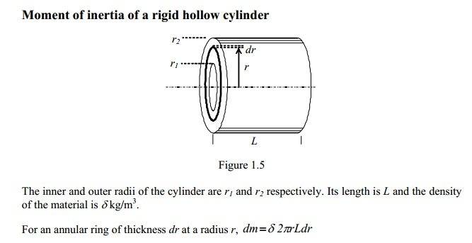

Diagram of a hollow cylinder of length L with inner radius r1 and outer radius r2, showing a thin annular ring of thickness dr at radius r, with the centre axis drawn as a dash-dot line.
In the equation dm = δ x 2∏rLdr
Where δ = density, and
2∏rL = volume
How is it that the volume can be 2∏rL? The units of r is (metres) and the units of L is (metres) which leads to m2 (Area)
Should it not be ∏r2L for volume?
My reasoning that it's 2∏rL is because dm and dr are infinitesimally small such that the circle formed doesn't really have a surface area as such and therefore the volume is simply the circumference multiplied by the length...but that still doesn't make it a "volume"
Can anyone explain?
Thanks
Looks like you forgot the units of dr which is also meters.
The 2*pi*r*L is the area of a cylinder so 2*pi*r*l*dr is a volume element with dimensions of meters^3
You forgot to include the thickness dr in your calculation of volume. It has units of metres.
