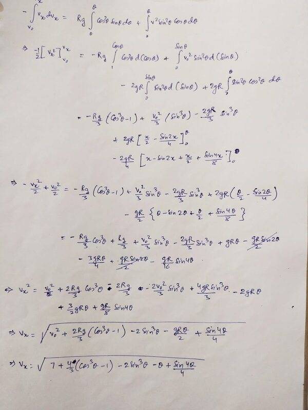

Here's my solution:
I've tried to find the equation of vx. But the graph that it is generating is not right. I am not able to figure out what is wrong in the equation for vx. Please let me know where is the equation wrong and what is wrong?
Here's the graph:
It says "till the combined mass is on the curved surface of the track ", but you seem to be analysing it while it is on the curved surface.
Is there perhaps a second part to the question, which asks for that, or have you misquoted the question?
Wrt your working, where you introduce the integral signs you have moved a v2 term outside, but v is a variable.
The combined mass will eventually fly away and will fall at the junction of the straight path and the curved path. I'm trying to find out the horizontal velocity of the combined mass as long as it is traversing on the curved path.
However, your observation is correct. I've mistakenly kept v^2 outside the integral sign. I'll work on it and see if it gives a satisfactory answer.

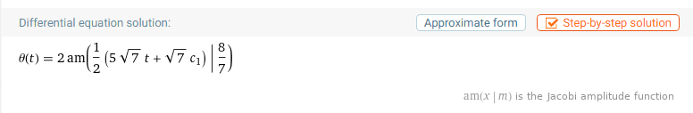

I tried solving for theta(t). The equation I got is:
##\frac{d\theta }{dt} = \sqrt{\frac{v_{0}}{R^{2}}-\frac{4g}{R}Sin^{2}\frac{\theta }{2}}##
I couldn't solve it manually. However, when I used Wolfram Alpha I got a solution, which I'm sure I do not understand: Check this link:
https://www.wolframalpha.com/input/?i=dθ/dt+=+sqrt(175-200sin^2(θ/2))
The solution that wolfram is showing is this:
Is there any other way without using Jacobi Amplitude function ?

The physical system while the mass is on the lower quadrant is identical to a very well known one which is mostly taught only in the small angle approximation, for the very good reason that a full analytic solution involves infinite series.
Are you quite sure you are expected to solve this? As I pointed out (but I'm not sure you understood), the question as you quoted it in post #1 does not ask you to solve it.
a very known one.. ! What am I missing here.. Could you please elaborate ?

I had thought that you might be talking about Pendulum. but then thought may be you might be talking about something else too..
Do you see that the physics are the same?

I also understand that I could have found vx as simply vcos(theta). However, the equation that I've written doesn't seem to be wrong. Still I'm not getting the same result for vx as I could have gotten by using vx=v*cos(theta).
Here I've tried to calculate after including v^2 inside the integral sign. Still the expression that I'm getting is not giving the same result as vcos(theta). Could someone please let me know where I'm going wrong if the equations are right to begin with.

In my post#1, I've written an equation:
$$-m\frac{dv_{x}}{dt}=NSin\theta =(mgcos\theta+\frac{mv^{2}}{R})sin\theta $$
I suppose this equation is not wrong.
Then I've proceded to solve for ##v_{x}## . In post#2 you had correctly mentioned that I've mistakenly kept ##v^{2}## outside the integral. Therefore, in post#22 I corrected that mistake and included ##v^{2}## inside the integral. Still, after solving for ##v_{x}##, the equation for ##v_{x}## is not the same as could have been found by using ##vcos\theta ##. That is what I don't understand, that if my 1st equation is right, then where am I going wrong that I'm getting a wrong equation for ##v_{x}##.
Ok, I see now, your post #22 continues from the corrected integral in post #1.

Here I've tried to calculate after including v^2 inside the integral sign. Still the expression that I'm getting is not giving the same result as vcos(theta). Could someone please let me know where I'm going wrong if the equations are right to begin with. View attachment 272567
This one is easy: The mistake is in the second term of your top line (post 22): It should be ## \sin{\theta} \cos{\theta} ##, not ## \sin^2{\theta} \cos{\theta} ##. Edit: and I checked the integrals using ## v^2 ## correctly. It works and gives ## v_x^2=v^2 \cos^2{\theta} ##.

Thank you @Charles Link so much. That was very helpful. Yes it finally results in the equation ## v_x^2=v^2 \cos^2{\theta} ##. I'm glad it finally worked out nicely.
