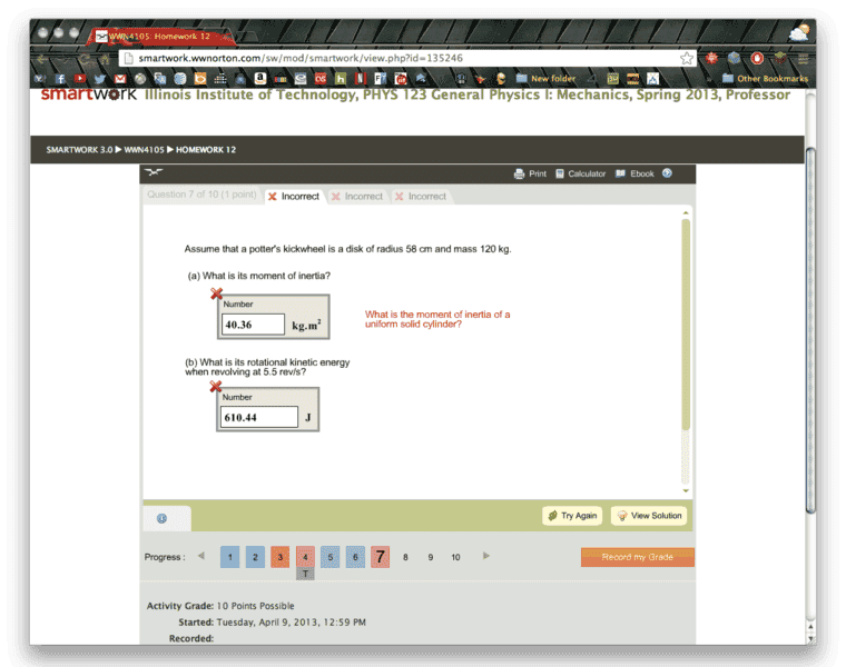

for part a I used the equation I=m*r^2 ---> 120(58/100)^2=40.36 kg*m^2
b)I know how to do this using the equation K=1/2Iw^2 but my moment of inertia is incorrect.
What is the moment of inertia of a uniform disk of mass, M, and radius, R ?
I used the equation 1/2MR^2 and got =20.18.
when I plugged everything into the KE equation I had 305.22 J but that is incorrect.
What are the units for ω ?
rev/s
Sneakatone said:
rev/s
The rotation rate is given you in rev/s, but what units does it need to be into plug it into the formula for KE?
should it be rev/min or rad/s?
I got it now it should be in rad/s for some reason I thought It was suppose to be rev/s.
Thank you all!
