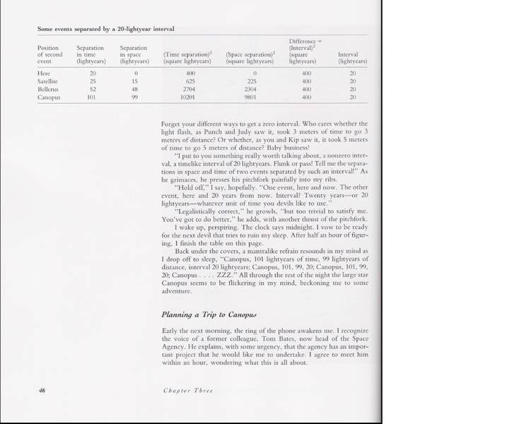

I do not understand the difference between separation in space and separation in time. Could someone please explain the following positions to me? I would be very thankful and appreciative if so.
Position of event 1: Separation in time (lightyears) = 20. Separation in space (lightyears) = 0
I think of light years as a measure of distance. So if separation in space is zero, then that must be my exact location, so how can it be 20 light years away in time?
Position of event 2: Separation in time = 25. Separation in space = 15.
If I think of light years as distance, how can the two be different?
Position of event 3: Separation in time = 52. Separation in space = 48.
Same confusion as #2.
Position of event 4: Separation in time = 101. Separation in space = 99.
Many thanks!

This is from a book I am reading. It doesn't make sense to me either! Here is what I'm referring to. I could have been explaining it poorly.
I'm not sure about the other posters positions, but imo you are understanding it correctly.
they're isn't any difference between the two, besides them being "opposite". A similar kind as symmetrical relationships.
I see time/length as having this kind of relationship/(a link to wiki),
lol so length/time are "something from nothing which is something*" (as in your textbook saying "Never mind the (light-like) interval is ZERO")
*statement I read on that wkiki-page speaking about the philosophical view about going from the number "0" to "1", i.e. 0 is two equal but opposite "units/things/whatever".

Ahhh, I see. Now in the case of your example, the separation in space is near zero, if I am reading it right. That is, if distance is in terms of light years. Many thanks.
Now I see where this book is getting lightyears as a unit if time. In the Minkowski metric the time component is often multiplied by c (the speed of light) to make the units the same for all components. So if you have events that happen a year apart, their time separation would be c times 1 year= 1 lightyear.
The idea of a lightyear being a unit of time (as opposed to the year) comes from geometrized units. It crops up fairly regularly in relativity. The basic idea is similar to the idea of natural units, except that in natural units c=1 still has dimensions of length/time whereas in geometrized units c=1 is dimensionless.
Here is a wiki on the topic.
http://en.wikipedia.org/wiki/Geometrized_unit_system
You can always go from geometrized units to other units simply by putting the units back into the variables and then looking to see where your units don't match. Then you multiply by powers of c and G to get the units correct.
