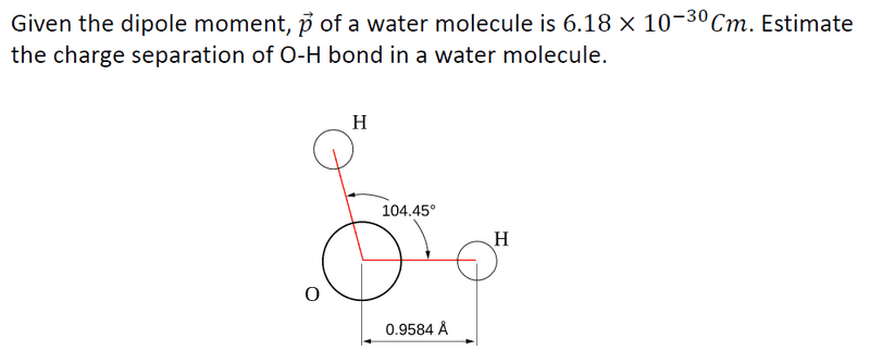

Please see below
p = qd
resultant vector
cosine rule
I thought by "charge separation" the question is asking about distance between H and H so I was thinking of using cosine rule to find the distance. It turns out the answer stated by answer key is 0.328e (which I don't know what that is)
Dipole moment has direction from negative to positive charge so by using formula of resultant vector:
$$6.18\times 10^{-30}=\sqrt{a^2+a^2+2a^2 \cos 104.45^o}, \text{where} ~ a ~ \text{is dipole moment of O-H}$$
$$a=5.04\times 10^{-30}Cm$$
I try to use formula of dipole moment ##qd## where ##d## is ##0.9584\times 10^{-10} m## and I get ##q## to be 0.328e, which matches the answer key, but I don't know what it is.
Is that the charge of O or H or something else?
Thanks
Answer deleted - sorry for any confusion.
Is "charge separation" the same thing as "separation of charge"? The latter was used in my lectures, which was a distance. I don't know about the former though. According to your answer key, it looks like "charge separation" is a charge?
Also, when you are using the formula of a dipole moment, I assume when you use ##qd##, you are actually using ##2qd\cos(\theta /2)##?

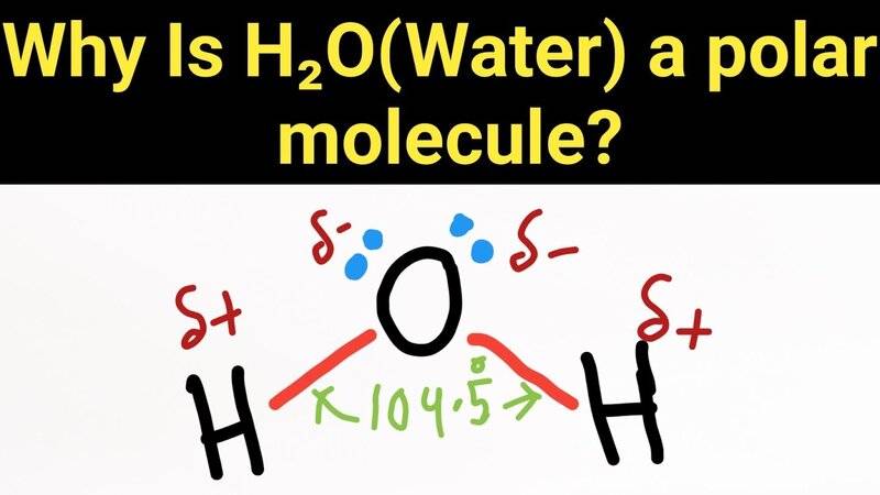

@laser1 spotted the problem. The term 'charge separation' here does not mean a distance. It means the effective charge at each end of an O-H bond. Shown as ##\delta## values in the image below:
https://i.ytimg.com/vi/kbn27lXQNYk/maxresdefault.jpg
Oxygen is more electronegative than hydrogen. In a water molecule, this results in a shift of the electron-distribution towards the oxygen. Read about polar molecules and electronegativity if you need to find out more.

Yes, this is the same as the method I use to find ##a## where ##a## is equal to ##qd##

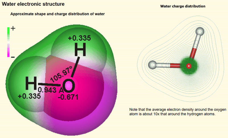

For more insight, take a look at this presentation: https://water.lsbu.ac.uk/water/water_molecule.html

You have calculated the magnitudes of the partial charges at the two ends of each O-H bond. The two partial charges each have a magnitude 0.328e.
If you have done sufficient chemistry you will know that oxygen is more electronegative than hydrogen; consequently the O-end partial charge will be -0.328e, and the H-end partial charge will be +0.328e.
As already stated by @haruspex, these are not actual charges. They are effectively average values of charges arising from distortions in the shape of electron orbitals.
(It’s also worth noting that a water molecule consists of two O-H dipoles sharing the same O atom. The total partial charge on the O atom is 2 x -0.328e = -0.656e, but this is not what the question asks for).
