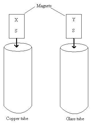

A magnet is dropped down each the copper and glass tube. What direction is the induced current in the copper and glass tube respectively?
a)clockwise, clockwise
b)clockwise, no induced current
c)counter clockwise, clockwise
d)counter clockwise, no induced current
None are necessary.
I think the answer is b) clockwise, no induced current. Using the left hand rule the direction of the magnetic field in the copper tube is upwards and the direction of the current is clockwise. Current cannot be induced in a glass tube. Am I right?
Your answer is correct.
