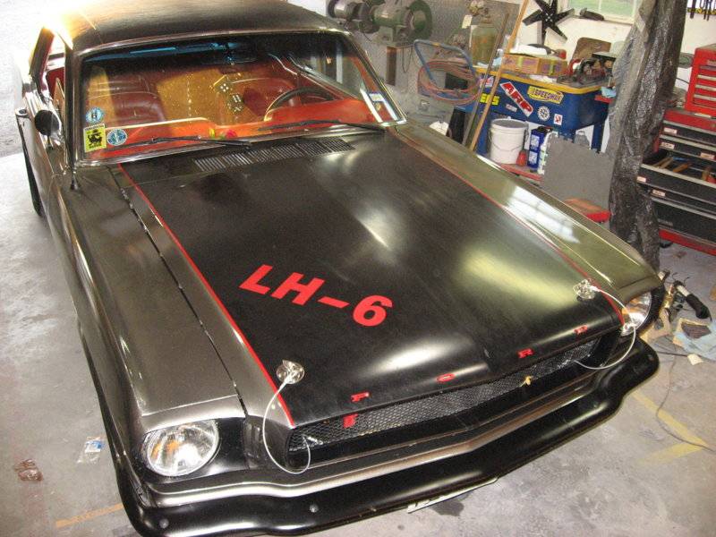

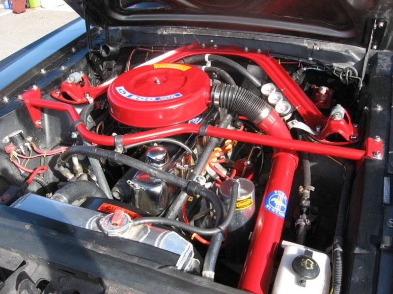

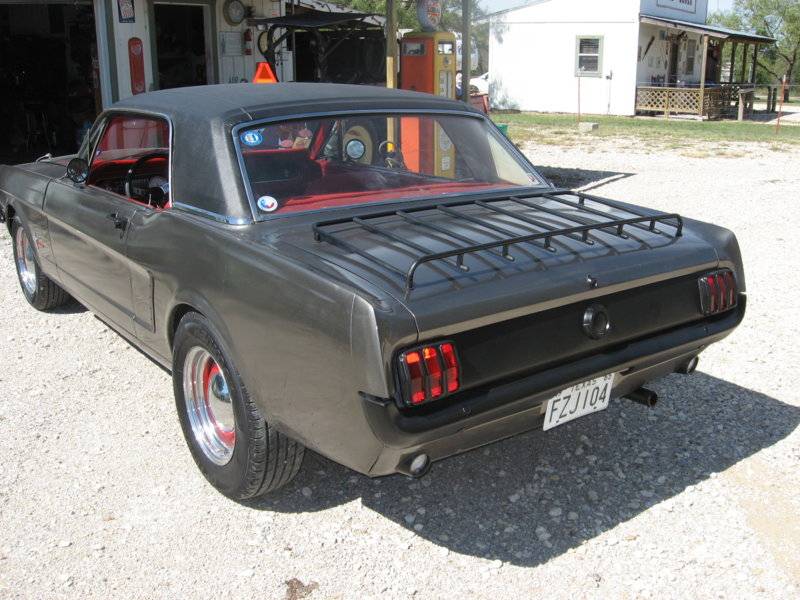

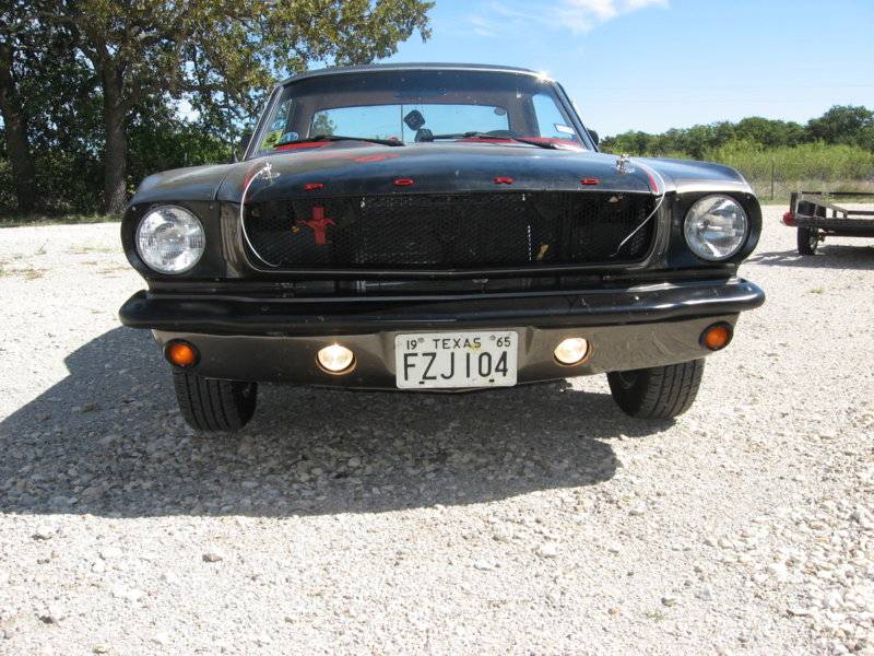

Using on-line formulas I show my modified 65 Mustang SIX-Cylinder can reach 122 MPH...don't think so! I understand outside forces act on a moving object, requiring more force to act against that force, to increase speed. I am old and not an engineer, so please excuse me if I use wrong terms, but I am sure you will understand my question. With roughly 140 HP at 4300 RPM, (I think it could pull that in high gear given enough room...say Kansas), a vehicle weighing 2850 LBS, with 26.3" tall rear tires, and 2.83-1 rear gears, hauling an old corn-fed 210 pound guy, what do any of you think a top speed would be? The frontal area is roughly 5' x 2.75' plus the windshield at 5' x 1.5'. All undercarriage stuff is tucked well up under the chassis and the car has been lowered about 2". Don't ask how I know, but I do know it will go past the century mark on the speedometer. Some of the guys who ask me questions think their 6-cylinder can top 130 or even 140, (as if their Pony is a Shelby GT), and my explanation of HP needed to get from 0 to 100, is probably less than that needed to add another 40 MPH. I am not sure they understand what an "Exponential Curve" is.
Since the drag-limited top speed is somewhat complicated to calculate accurately, you could start by estimating what the theoretical engine RPM-limited top speed is. Given your engine's redline, final drive ratio (top gear in transmission multiplied by differential ratio), and tire diameter you should be able to estimate what your top speed would be if we assumed the engine had more power than drag.
Mech_Engineer, that 122 MPH is the speed I got off-line using drag, gears, tires, weight and frontal area. NO WAY will my Mustang SIX go 122 MPH. I am a long time engine builder and my old 1940 Ford coupe, one of the most aerodynamic cars made, would have trouble actually hitting that speed. It had a 289 Mustang V8, 2.79 gears, big-car flywheel, 29" tall rear tires, bored .040", 4-barrel, hot ignition, cast iron headers and more. "It" possible could, but I am sure my SIX can't. My math using a Cd of .40, Crr of .017, weight of 3050 counting driver, the listed tires/gears, 70 degrees F, Barometric Pressure of 30 HG, I come up with 122 MPH. Surely my math ability sucks! That is why I am here where people understand formulas and math better than me. The little Mustang is light and I have modified it considerably, but 122 MPH seems way to fast for 140 HP. Any ideas where I am going wrong? Thanks for any help.

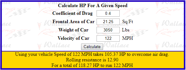

From a purely theoretical perspective, the drag equations you're trying to use (or ones similar to it) seem to indicate only about 118 hp is needed to overcome air drag and rolling resistance at 122 mph. If the car can never reach that speed, it has to do with how the power's being put to the ground, but remember theoretical calculations make a lot of assumptions and can really only be used as a guideline.
http://www.wallaceracing.com/Calculate HP For Speed.php

One more thought- the limiting factor will be wheel horsepower, not crank horsepower. If your car puts out about 140 hp at the crank, after transmission efficiency loss it might be only 90-95 horsepower to the wheels (if you have 30-35% loss for transmission/drivetrain loss). This is why dyno guys are always bragging about wheel horsepower, because that's what actually makes it to the ground and pushes the car forward.
Thank you very much Mech_Engineer. Having built and raced cars I just did a quick math check. A 140 HP motor at the flywheel, makes about 119 HP using a standard 15% loss, due to mechanical things happening before the rear wheels. All the drive-line is new or rebuilt and is tight and well set-up. If 118.27 HP is needed, maybe it will top-out at 122 MPH...but I will not bet on it. My reason for all this, is to show other 6-cylinder Mustang owners (with motors much less modified than mine), who think their new header and loud muffler just added 40 HP, it probably did not add that much. And achieving a very high top-speed requires lots of true on-the-ground HP. My 206 CI SIX is built for torque, and I feel sure it can pull 4 grand or close to it in top gear. I keep it tuned and have driven it very fast just to check out the modified suspension, disc brakes and motor...but just once. Once past 100 MPH the little car gets VERY light, even with an added rear sway-bar, gas shocks, poly bushings and GT springs. Nice to know the little motor can pull, and with a 287 CFM 2-barrel, it still had something left. I ran out of stuff, not the car! Thanks again.
