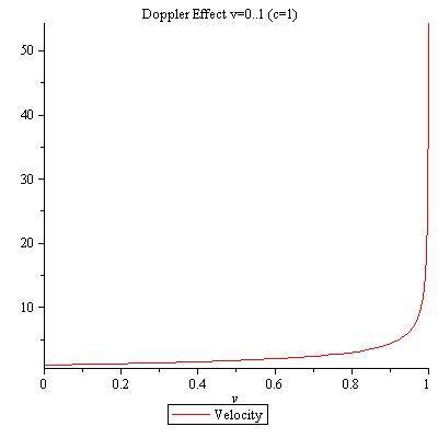

lenfromkits said:
What I'm trying to figure out is if the change in frequency observed is linear compared to the speed, or if it is relativistic and a small change in frequency compared to the speed.
Look at this graph that should give you the answer if it is linear or not:
Thanks! You have no idea how much it helps to clear things up when someone spells it out like that :)

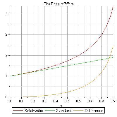

Do we have yet any observational evidence of the relativistic aspect of the Doppler shift? (ie, for high velocities where 'v' is closer to 1 - are there any examples discovered yet?)
Here is a plot showing the relativistic and non-relativistic Doppler shift and the difference between them.
Did you know by the way that if the motion is not line of sight but instead transverse the Doppler effect is very different? In this case it is basically the relativistic time dilation, so for a 'train' approaching or departing the station it is:
<br /> {1 \over \sqrt{1-v^2}}<br />

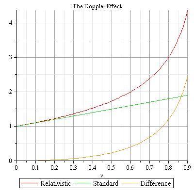

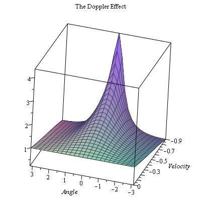

Relativity teaches us that when a light source approaches we can still have it being redshifted.
Here is a 3D graph that shows the Doppler of an approaching source for different angles. It is hard to see but if you look good you can see the shift is maximum if the angle is 0 and that for very wide angles there is actually redshift instead of blueshift (e.g. the flat parts on the sides go below 1 for high velocities).
