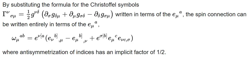

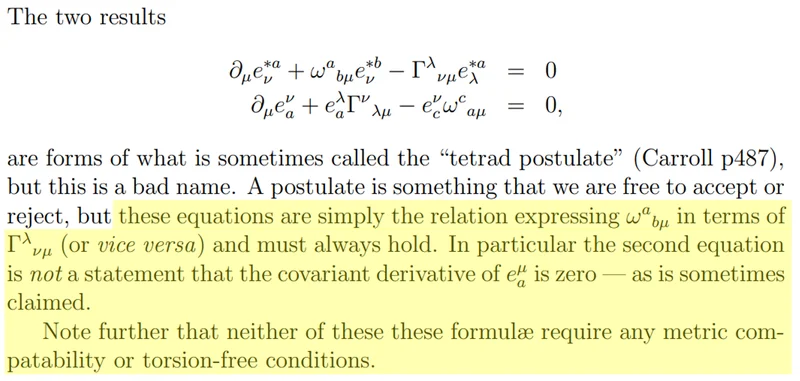

I read some papers about teleparallel connection. I have a question:
When we introduce spin connection ##\omega^a_{\hphantom{a}\mu b}##. And get the full covariant derivative of the tetrad:
\begin{equation}
\partial_{\mu}e^a_{\nu}+\omega^a_{\mu b}e^b_{\nu}-\Gamma^{\alpha}_{\mu\nu}e^a_{\alpha}=0
\end{equation}
And tetrad ## e’^a_{\nu}## satisfy the equation:
\begin{equation}
\partial_{\mu}e’^a_{\nu}-\Gamma^{\alpha}_{\mu\nu}e’^a_{\alpha}=0
\end{equation}
If connection ##\Gamma^{\alpha}_{\mu\nu}## is same in the two equation. Then what is the difference between ## e’^a_{\nu}## and ## e^a_{\nu}##?
I'm struggling a bit to follow your train of thought-
The tetrads ##e'## and ##e## are related by a (local) Lorentz transformation, i.e. ##e' = \Lambda e##.
You mention the spin connection ##\omega##. It too transforms, precisely because the tetrad postulate:
##\nabla_{\mu} {e^a}_{\nu} = \partial_{\mu} {e^a}_{\nu} + {\omega^a}_{\mu b} {e^b}_{\nu} - \Gamma^{\sigma}_{\mu \nu} {e^a}_{\sigma} = 0##

Your equation is not an integrability condition that must be satisfied by ##e,\omega,\Gamma##. Instead, it simply defines the spin connection. From page 5 of https://people.physics.illinois.edu/stone/torsion.pdf:
So you are free to select any arbitrary tetrad field ##e## and any connection ##\Gamma## (including one with arbitrary torsion and arbitrary nonmetricity) and use these equations to define a consistent spin connection ##\omega##.

Not according to the reference I posted above. Only the tetrad ##e## and connection ##\Gamma## can be independently and freely selected, from which the spin connection ##\omega## is then derived. Can you quote a credible reference that says otherwise?

The tetrad ##e## and spin-connection ##\omega## appear nowhere in the Schmidt paper. And your later GitHub reference is not refereed so it's disallowed on Physics Forums.
My citation in post #22 explicitly states that the equation:$$\partial_{\mu} {e^a}_{\nu} + {\omega^a}_{\mu b} {e^b}_{\nu} - \Gamma^{\sigma}_{\mu \nu} {e^a}_{\sigma} = 0$$is nothing more than the definition of ##\omega## in terms of the arbitrary chosen fields ##e,\Gamma##. (Equivalently, it can serve to define ##\Gamma## in terms of arbitrary ##e,\omega##.)
You on the other hand wish to discuss something different: choosing the two connections ##\Gamma,\omega## independently, from which you then derive a path-dependent tetrad ##e##. But this puts the burden on you to cite a credible published reference that implements this approach and demonstrates that it leads to a consistent theory of gravity in spacetime. If you cannot produce such a reference, you are proposing a personal theory that is off limits in Physics Forums.
