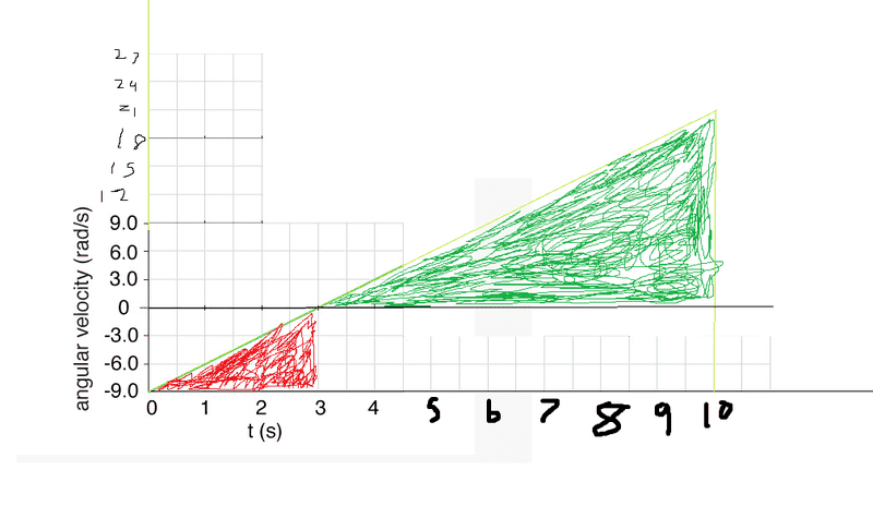

tried my best to draw out the graphs with only ms paint.
so this is what I was suppose to do, the green triangle should be above the x axis. then subtract the red triangle from the green.

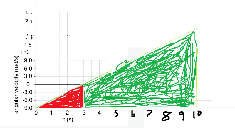

here is what I did, which was wrong, I took the area of the whole triangle, and subtracted the red triangle. As you can see, the area of green is much bigger.

Note that the red triangle that you evaluated the area of is the wrong one. You want the area above the slanted line and below the x axis.
That is a cosmetic error, however, because the area of both those triangles will be equal.
Very good.
So, starting with the area of that monster triangle, subtract the red triangle, then subtract it again, then deduct the rectangular area of green that you don't want, should, in a roundabout way, give the answer, too!
Much better to sketch the graph right from the start so that you can see what you are doing.
