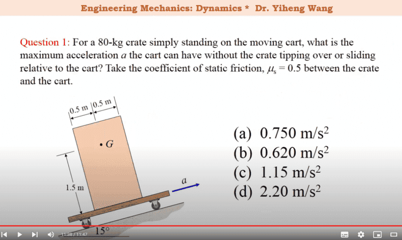

What Is the Maximum Acceleration of a Crate Up an Incline Before Tipping Over?
The discussion revolves around determining the maximum acceleration of a crate on an incline before it tips over. The problem involves concepts from mechanics, specifically relating to forces, torques, and friction on an inclined plane.

Correct answer is (b) 0,620 ms2

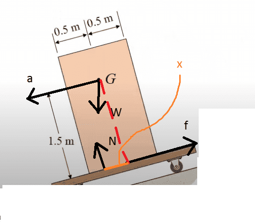

My attempt:
FBD
Equation 1. ∑Fx=0=−ma−Wsin⁡(15)+f
N=Wcos⁡15
f=Nμs=379,03N
Equation 1. ma=f−Wsin⁡15
15a=379,03−203,1
a=2,20ms2
Equation 2. ∑MG=0=−Nx+f1,5
x=0,75m
What is the condition for tipping over to occur?
x need to be more then 0,5
And what is x?
Why did you draw the point of action for the normal force they way you did?
For the crate to tip, a non-zero net torque is needed. I don't see a torque equation. Your value for the acceleration of 2.20 m/s2 is the value at which the crate will start sliding assuming that it does not tip. If the crate tips before it starts sliding, the 2.20 m/s2 cannot be the answer. You need to find another value for the acceleration at which the crate will tip assuming that it does not slip and pick the smaller of the two values as the answer. As @Lnewqban asked,

Your answer
is a non-answer because x cannot be greater than 0.5 m.

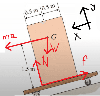

kuruman said:
Yes, that's what I suggested. Please post your work for finding the maximum acceleration before tipping occurs.
W - weight = ##W = m*9,81 = 784,8##
N - normal force On left edge because it will tip over that edge and all weight will be there.
##N = W\cos15 = 758,1##
f - friction
Equation 1##\sum F_x = 0 = ma - f + W\sin15##
##\sum M_G = 0 = -N0,5 + f1,5## --> ##f = 252,69##
From equation 1 we now find a.
##a = 0,62##

Why will the block tip if there is no unbalanced torque acting on it? Do you understand torques? What do they do?
Sum of all torques is 0. And it will not tip.
When we set normal force to be on edge we find maximum acceleration at at witch crate will not tip.
If acceleration is bigger then 0,62 it will tip.

You still seem to be tangling up the two cases.
In post #1, you successfully found the max acceleration assuming that it will slip rather than tip.
where I assume you used the f calculated from the first case, but you should now be assuming that it will tip rather than slip, so that f value is irrelevant. Take moments about the tipping point instead.
In post #11, you made the converse error: found f assuming tip but applied that value to the slip case.
That all is just tip case.I did not post solution for slip case.
For slip case i get different value for friction.
Sorry, you are right. I agree with your answer.
