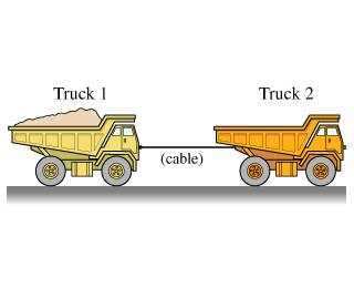

A loaded truck (truck 1) has a maximum engine power P and is able to attain a maximum speed v. Another truck (truck 2) has a maximum engine power 2P and can attain a maximum speed of 1.5v . The two trucks are then connected by a long cable, as shown.
To solve this problem, assume that each truck, when not attached to another truck, has a speed that is limited only by wind resistance. Also assume (not very realistically)
A) That the wind resistance is a constant force (a different constant for each truck though). i.e. It is independent of the speed at which the truck is going.
B) That the wind resistance force on each truck is the same before and after the cable is connected, and,
C) That the power that each truck's engine can generate is independent of the truck's speed.
Find v_max, the maximum speed of the two trucks when they are connected, assuming both engines are running at maximum power.
Express the maximum speed in terms of v.
I don't have the slightest clue. Am i using Work-Energy theorem in one form or another? Some guidance would be great.
Power is the rate at which work is done, so you will need to look at work. Since you need to evaluate the work, it would be good to start by showing all of the forces acting on each truck.

When the velocity is constant, there is no net force acting on each truck; there are still forces present, but they add up to zero. Because the forces add to zero, the total work on each truck is zero. But the power from each engine is the rate at which it must do work in order to overcome forces opposing it.
Besides the tension force, what other forces in the horizontal direction do we need to consider?

We have the drag force, which is independent of the velocity, and we also have the tension. I'm assuming the power is a force that needs to be considered as well?

Keep in mind that the drag forces are different on each truck. Let's also call the applied force from each engine F1 and F2 for the moment; we need to work out what their actual relationship is, and it's not 2:1.
Otherwise, that's the idea for the force equations. They'd be
truck 2: F1 - F_d1 - T = 0 and
truck 1: F2 - F_d2 + T = 0 .
I see no mention of friction, so I take it that the rolling friction of the trucks can be neglected.
We need to figure out what the problem is telling us about the forces from the engines. What is the equation for work?

ok, after doing a little research I've read that P = F * v
I have a gut feeling we're going to have to use this?

That's where the rates come in. Power is [tex]\Delta[/tex]W / [tex]\Delta[/tex]t . So if we divide the work equation through
by [tex]\Delta[/tex]t , we get
P = [tex]\Delta[/tex][ F·x ] / [tex]\Delta[/tex]t ,
but when the force is constant, we have
P = F·[[tex]\Delta[/tex]x / [tex]\Delta[/tex]t ] = F·v .
We can now apply this to each truck. The maximum power of the engine in truck 1 is
P = F1 · v . What can we write for truck 2?

Careful: the problem states the maximum powers relative to each other. So you are close, but you need to write
P_max_truck 2 = 2P = (F2 * 1.5v) , where P = F1·v is the maximum power of truck 1.
(We need the comparative relationship because the question wants the maximum speed from the combined engines expressed in terms of v.)
So how does F2 compare to F1?

Exactly: we only have one equation in two unknowns, F1 and F2, so we can only find the relation between them. (That's OK -- we won't need to know the magnitudes of these forces.)
So v can be divided out, leaving 2 · F1 = F2 · 1.5 ,
or F2 = (4/3) · F1 .

We're not quite there yet. This v is the maximum speed of truck 1 alone; we're going to find v_max as a multiple of v.
So if i substitue back into force eq. of truck 2 with T solved from the eq from truck 1, i get:
(4/3)F1 + (F1 - Fd1) - Fd2 = 0
What is going on with the Fd1 and Fd2 now...
We're nearly there. We can re-arrange this as
Fd1 + Fd2 = F1 + F2 = F1 + (4/3)·F1 = (7/3)·F1 .
[You flipped a sign before the substitution, so I fixed that, since it's getting late...]
The point is that the two trucks working together provide a combined applied force of (7/3)·F1 . The combined force equation we created just says that this combined force is equal to the combined drag force, as we'd expect, since the net force is zero because the velocity is constant. This is just the sum of the individual drag forces, as specified by the conditions of the problem: the drag forces do not depend on speed (rather unrealistic) and are not affected by linking the trucks with the cable.
All of this is by way of justifying what we are about to do to finish the problem. The two trucks linked together provide a combined power of 2P + P and a combined force of F1 + F2 = (7/3)·F1. So if we write a power equation for the combined engines, we have
P_total = 2P + P = (F1 + F2) · (v_max) .
Since we stated earlier that P = F1·v , we can now find v_max in terms of v.

Wow, like i would've ever gotten this on my own! haha.
ok so...
2(F1*v) + (F1*v) = (7/3)F1 * v_max
v_max = [3(F1*v)]/[(7/3)F1) ---------> F1 cancels and we're just left w/ v =
v_max = (9/7)v ---------->BAH! tell me that's right, lol
That is the right answer. Thank you very much dynamicsolo. I have a hard time thinking about setting problems up like this, but i always understand the concepts behind it. Setup is by far the hardest part.

That's what I got, too. You're sort of forced to go about this in a somewhat roundabout way because only relative values are given, rather than magnitudes.
You get a value a bit less than 1.5 v , because the more powerful truck is using some of its power to tow the weaker truck (#1) to greater than #1's own maximum speed.
