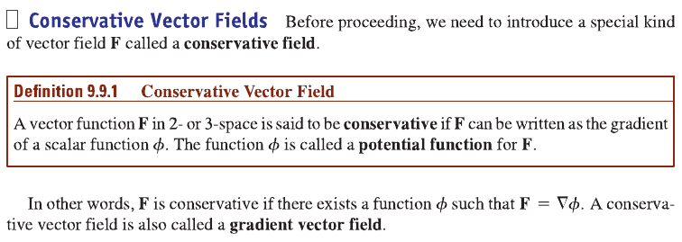

Here is the usage in the following context:
Textbook page excerpt on conservative vector fields: Definition 9.9.1 states F is conservative if F can be written as the gradient of a scalar function phi, and F = nabla phi.

Also, if we take a look at the OP's picture:
ainster31 said:
Textbook excerpt titled Conservative Vector Fields, with Definition 9.9.1 stating a vector field F is conservative if F equals the gradient of a scalar function phi, and F = grad phi.
The F does not have an arrow above it either, even though it is a vector field. It is bolded instead--textbooks usually do this instead of putting an arrow above a vector. It is hard to tell but the del might also be bolded too. Therefore it is hard to draw conclusions from that picture whether or not del should be drawn with an arrow.
