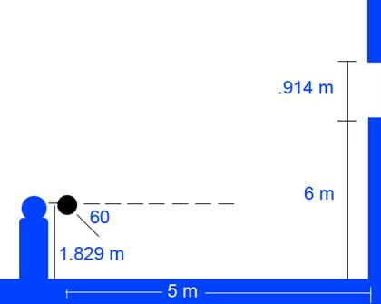

Consider there is a window 5 meters from a person. The window is sized 1.21 meters (4 ft) in length and .914 meter (3 ft) wide at a height of 6 meters from the ground.
A person 1.8288 meters tall (6 ft) wants to bounce a ball (COR: 0.789) on the ground such that the ball goes through the window on the first bounce.
If the person bounces the ball with a speed of 25m/s at an angle of -60° from the horizontal at a point in the middle (between him and the wall), calculate and plot the trajectory of the ball.
Will the ball go through the window? If not, change one of the values such that it does. Then find a RANGE of velocities that will meet this condition, while keeping the COR, Distance, and angle the same.
5f1a2016-7937-4180-bdab-e389dfb569d2.jpe
X0(t) = V0cos(theta)t
Y0(t) = V0sin(theta)t - g/2t^2
V = V0(alpha)^n : alpha = the COR, n = the bounce
I formulated an excel sheet to calculate where the ball was at 5 meters along the x direction and discovered that it was too high of a position and would hit above the window. After changing the velocity to 20 m/s it seems to work.
My problem is writing this in a simplistic formula. As well, finding the range of available velocities without having to use an excel spreed sheet for each calculation by "guessing" and trying each available velocity until i find a max and min.
Thanks for any support in this! <3

Same things as you found V1=eVo (normally "e" represents COR) but before you have to find the X1 distance for projected downward motion is equal to 1m.
Then, you have X2 distance for bounced upward motion is 4 m and to get the time ~ 0.4s.
Therefore, using vertical equation for y=V1sin 600t-0.5gt2.
That is my solutions.:smile:
I must be doing something wrong. How did you solve for the position of X1 at the first bounce? Can you give a more detailed explanation?
I was given a hint by my professor :
Hint: Look at equations for x(t) and y(t). You could eliminate time from the equations and get an equation for y(x)

You just need to apply these two formulae, X1=V0cosθ t and Y1=V0sinθ t + 0.5gt2 to get your X1.(Find up the t from Y1 first)
I have to notice that if you let θ=-600 then your displacement of Y1 also in negative sign.That is why i shown this Y1=V0sinθ t"+"0.5gt2 .
I got .08s for the t where it reaches the ground at x1
Yup !
After then you can get X2=5-1=4 m.
Therefore, from X2=V1cosθ t1 => t1=X2/V1cosθ.(t1 is for the range X2 and displacement Y2 of bounced upward motion).
Finally, t1 into this formula(Eliminated the t1):
Y2=V1sinθ t1 - 0.5gt12. To get your answer.:smile:

Normally, the Range of X2=V1cosθt1 .So, Range of Velocity is V1cosθ= X2/t1 => VX2=X2/t1. And same things to Range of X1.Apply this θ=tan-1(e tan 600). Please check it out the answer. Y2 is too low.
Very sorry to you.:redface:
Oonej said:
Now how do you find the range of velocities to make it through the window?
Let say the maximum height for Y2 go through the window is equal to 6 m meanwhile the final vertical velocity Vyf=0 for Y2.
Therefore, apply V2yf=V2yi-2gY2. Because Viy =V1sinθ.So,you can get the V1 after that you can get the V0.:smile:

I have discovered that the ball DOES NOT go through the window with the given spec's. But after some brute forcing an excel sheet. I discovered it does go through the window with an angle of -70 degrees at a velocity of 35 m/s
Now I'm stuck at the second part with finding a range.
Ok, more progress...
y2 = x2 tan θ - [ g / ( 2 v1^2 cos^2 θ ) ] * x2^2
using this formula, and changing the degree to 73 (but keeping the velocity at 25 initially which made it through the window. since i was only allowed to change one variable I made it be the angle)
I am getting a few velocities off it seems. minimum calculated out to be 19.1127, but could probably still be a bit slower. and 26.678 for max, but seems it could be a bit faster.
Something I am doing is slightly off. I think it has something to do with the initial x1 value not being calculated correctly.
X2 = 5 - x1, so plugging in 5 won't work, and we don't know what x1 is. Any ideas?

i think we can solve like this:
split initial velocity u into into 2 X,Y components ucosθ and usinθ
during collision and falling X component will experience no change
final velocity in Y, vY can be found out by: vY = e u'
here u' is new value for usinθ after falling 6ft
now for what distance it travels during this first part of motion can be found out by two ways,
I, shorter and using 1 simple formula:
[tex]y = xtan\theta - \frac{gx^2}{2u^2 cos^2\theta}[/tex]
i always prefer not using this formula
II, general way
use [tex]y = u_yt + \frac{1}{2}gt^2[/tex]
and find t
now use X = ucosθ t
hence we find uX, uY and distance from point of initial projection
i will continue rest later
Your way doesn't work, when we have 2 unknowns. We can't find T and V at the same time... or can we?
ok, you have chosen a complicated problem. from what i have read so far your calculations of [tex]x_1[/tex] = 1.037 m and [tex]t_1[/tex] =0.083 s are correct, though you have rounded too much which is why my results are slightly different.
the situation now gets a little more complicated. the speed in the y-direction increases slightly during this first part of the motion. I calculate the speed in the y-direction right before the bounce to be -22.4636 m/s and so the total speed of the ball just before the bounce is [tex]v_f[/tex] = 25.7 m/s.
Also, the angle the ball strikes the ground at will no longer be 60o. the angle I get is now 60.91o.
Here we have to make an assumption; namely that the ball will obey the law of reflection and bounce away at the same angle it came in. this is not unreasonable, but there are plenty of circumstances in which this would not happen. But, let's make that assumption.
ok, so now the ball bounces. it leaves the floor at an angle of 60.91o with a total speed of [tex]v_2[/tex] = 20.2773 m/s. thus, [tex]v_x[/tex] = 9.86 m/s and [tex]v_y[/tex] = 17.72 m/s.
Now, you can calculate how long the ball will take to travel the remaining horizontal distance, and then find the altitude at that time.
In order to find a range of initial velocities, you need to repeat the whole problem, but do not put in a value for [tex]v_o[/tex]. the result will be an expression for the altitude that depends on [tex]v_o[/tex].
hope this helps.
that is a perfectly wrong assumption
its true only when e=1

yeah the reflecting angle is (COR)(THETA)
Well, from my understanding, you are saying to solve for t, but we don't know what Uy or Ux is...
isnt u 25m/s?
if you followed the post, we discovered that that the angle -60 degrees, 25 m/s velocity, with the given heights does not work. After further investigation, NO velocity at -60 degree's works. Thus I changed the angle (as it requests in the problem) to -73 degrees. Which works.
Now the goal is to find a range of velocities for the minimum and maximum (through the window) which my lap professor told me would be easiest by combining the formulas y(x) and solving for V but it gets tricky when we don't know what the position is at X1 ( the first bounce) because my formula:
is requesting X2, but X2 is actually the distance from 5 - X1...
in my opinion, anything we say about the angle of reflection is suspect. there are simply too many factors to account for (is the ball spinning, the coefficient of friction, etc.). so, i think my assumption is a fair one.
i fail to see how the COR has much to do with the angle. from what i understand it is just the ratio of outgoing speed to incoming speed. if the angle depended on that ratio, we would see some strange things indeed. for example, if i throw the ball almost straight down, say 88o, and the COR is 0.25. then we should expect the ball to shoot off to the right at 22o above the horizontal. Now, I can make a ball do that, but it would take some serious spin and friction would be absolutely necessary. Maybe i am misunderstanding, but i don't see how COR can affect the angle.
