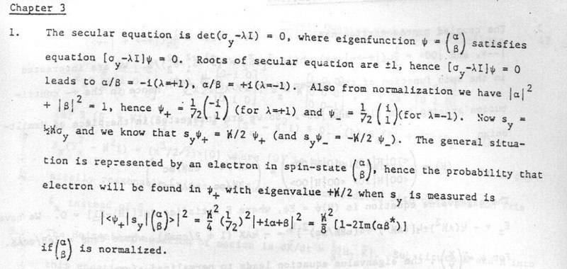

Suppose an electron is in the spin state alpha=(a,b). if s_y is measured, what is the probability of result h/2 ?
s_y eigenvector for +h/2 is |y+>=1/sqrt(2) (1,i)) so the probability is (<y+|alpha>)^2 . but in the solution i attached , the solution is different ! I'm confused !
thank you for your help

Don't bother, your solution is correct.
so the solution is incorrect ?
well there's certainly something wrong when you measure a probability in terms of \hbar2...
Yes, the solution is incorrect. Whoever wrote it made the common mistake of conflating making a measurement with applying the associated operator. In other words, the "solution" calculates ##\langle +_y \lvert \hat{S}_y \rvert \alpha,\beta\rangle## for the probability amplitude while you correctly calculated ##\langle +_y \vert \alpha,\beta\rangle##.
