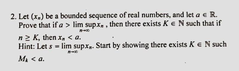

Printed homework problem 2: Let (xn) be a bounded real sequence and a in R. Prove that if a > limsup xn, then there exists K in N such that xn < a for n >= K. Hint: let s = limsup xn, show there exists K with Mk < a.
2. Relevant equation

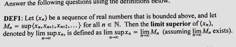

Below is the definition of the limit superior
Typed definition DEF1 of the limit superior: for a bounded-above real sequence (x_n), M_n = sup{x_n, x_{n+1}, ...}, and lim sup x_n is defined as lim M_n as n tends to infinity, assuming that limit exists.
