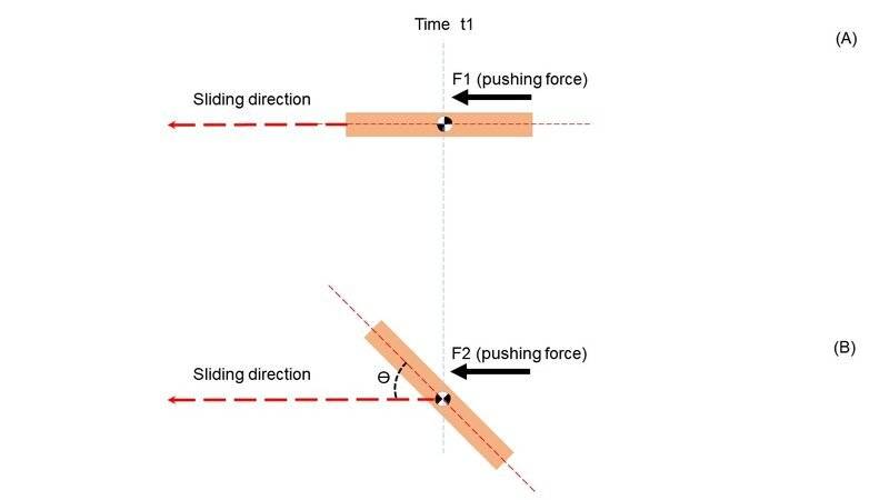

Two equal metal strips (each one 50cm) with different angles are pushed to slide on a straight surface by the equal forces F1 and F2 at t1, then we let them continue sliding. Object A slides with the velocity V’ and stops at t2 . Does the angle of ϴ have an effect on the velocity (V”) of object B? Which one would stop sooner (what is the relationship between traveling distance and forces)? Could we calculate the force along with object B? What is the difference between the friction forces? Is the equation ( F3 = F2 * Cosϴ ) correct?
F3 = F2 * Cosϴ
Fk = μk x N

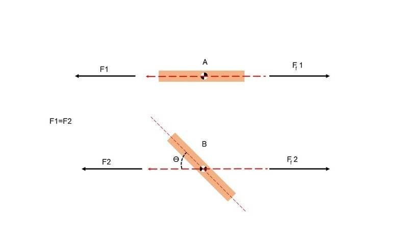

Two-panel diagram of a rectangular block sliding on a surface: (A) horizontal block with pushing force F1 to the left, friction Ff1 to the right, sliding direction to the left, labelled X'; (B) block tilted at angle Θ with pushing force F2 to the left, friction Ff2 to the right, F3 (?) along the tilted axis, labelled X'' (?); F1=F2.
  • Two diagrams of a rectangular bar with a centre of mass marker, pulled by equal forces F1 and F2 in opposite directions along a dashed line; the lower bar is rotated by angle θ from horizontal, labelled B, while the upper bar, labelled A, is horizontal.
Hi @Javad. You need to tell use what you think the answers are. Or at least say what you have considered. Then you'll get feedback/guidance. See here: https://www.physicsforums.com/threads/homework-help-guidelines-for-students-and-helpers.686781/
Note:
1) The diagrams show forces marked ##F_11## and ##F_12## but it is unclear what these represent. Friction?
2) The purpose/meaning of F3 is unknown.
The meanings of any symbols you use should be clear.
Also, if this is a set problem, you should provide the original question, word-for-word. Sometimes posters misinterpret a question and only tell us their version. This can lead to chaos and confusion!
Hi, thank you, I edited the question.
Two equal metal strips (the same material, the same size and mass, mass for each one is 500 g, and size for each one is 50cm* 5cm) are pushed on a straight surface to reach the same velocity (V1 = 20m/s) at the same time (t1), then we let them freely continue sliding. Object A slides while the sliding direction is along the longitudinal centerline of the object, object B slides while there is an angle (ϴ = 45°) between the sliding direction and the longitudinal centerline of the object. Which object will stop sooner (which object will travel a shorter distance (d))?
d = vt + 1/2at²
d = 1/2 (v + v˳)t
  • Two diagrams of an orange rectangular strip on a surface: (A) strip aligned with the sliding direction, a leftward dashed arrow, and a rightward push force F1 at time t1; (B) strip tilted at angle Θ to the sliding direction, with push force F2.

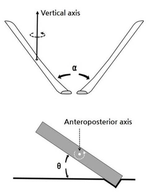

Thank you for your patience, I suppose the traveling distance for object B would be shorter (means the object will stop sooner) because (after time t1) the forwarding force declines to zero faster in comparison with object A due to the angle ϴ , but I do not know the related equations. I want to learn how making angles on skis helps to reduce the velocity of a skier to stop.
  • Two-part diagram of a skier: top view of a pair of skis splayed in a V shape with angle α marked between them and a vertical axis at one ski; bottom view of a ski on a slope at angle θ with an anteroposterior axis marked.
What is producing this 'forwarding force'?
Suppose the surface were perfectly smootth, what would happen after t1?
We apply pushing force (F1 and F2) on the objects to reach the same velocity (V1), then they freely slide and finally stop. After t1 each object will lose the initial applied force, I suppose they will stop at two different locations because object B has angle ϴ and will travel a shorter distance.
After t1, what force(s) act on each object?
There is no more extra force applying on the objects, they slide forward only by the initial force applied before t1 to reach the velocity (V1). But of course the friction force and air drag (please ignore the air drag) would work on both, however two objects are the same material on the same surface with the same coefficient of friction.
Yes!
Q1. Does the magnitude of the friction force depend on angle θ?
Q2. Does the direction of the friction force depend on angle θ?
Q3. Apart from the force of friction, is any other force slowing the objects down?
If you can answer Q1-Q3, you're nearly there!

Thank you for your time. Actually, I do not know the answers for all three questions, however as I know angle ϴ has no effect on the coefficient of friction, also we can ignore the question3. I think the correct answer should be in the concept of force vectors, like this equation Fᵪ=F.cosθ , while the moving direction is not at the same direction of force, more details are on this page (https://byjus.com/rajasthan-board/rbse-solutions-class-10-science-chapter-11/ ).
This is a ‘trick’ question designed to test your basic understanding.
Note that F1 and F2 have no effect after time t1. These forces have been removed so their components are irrelevant while the objects slow down.
Have another go….
Q1. Does the magnitude of the frictional force depend on angle θ?
Take a guess then click on the fuzzy text to reveal answer
No, The frictional force depends only on the coefficient of (kinetic) friction and on the normal reaction. The normal reaction equals each object’s weight in this problem. Therefore the magnitudes of the frictional forces are exactly the same for both objects.
Q2. Does the direction of the frictional force depend on angle θ?
No. The direction of the frictional force is opposite to the direction of motion. Since both objects move left, the frictional force on each object acts to the right.
No, The frictional force is the only force slowing each object. Note: without the frictional force, each object would continue to move left with the same speed forever.
So you should now know that:
- the force making each object slow down is exactly the same for each object;
- the force making each object slow down does not depend on θ;
- you should also know each object decelerates according to F=ma where 'F' is the frictional force.
So what can you conclude about how far the two objects travel?

Based on this conclusion, why a skier makes skis like a pizza slice during the stop phase (attached images). I am not sure but it might the skis lose velocity based on the equation Fᵪ=F.cosθ . I appreciate hearing your idea.
  • Instruction sheet titled Step 1, Basic Positions: 1. Pizza, to slow down, shown as a pizza slice with two skis in a wedge pointing inward; 2. French fry, to go fast, shown as fries with skis parallel.
  • Two diagrams: top shows a pair of skis viewed from above in a V shape with vertical axis and angle α between them; bottom shows a single ski tilted at angle θ to a horizontal surface with anteroposterior axis marked.
When changing the angle of the skis, skiers also make the leading edge of each ski 'dig' into the snow. This displaces snow, dissipating energy in the process. They have increased the coefficient of kinetic friction compared to a ski pointing forwards.
This is different to the problem you posted because (presumably) the surface in your problem is rigid (unlike snow).
(Also, when you write 'Fᵪ=F.cosθ', it is not clear what the force 'F' is. It can't be F1 or F2 because they have been 'switched off' after time t1. You need to understand the nature of each force acting to handle these sorts of problems.)
I am not comfortable with this characterization.
Rather this suggests that the interaction of skis with snow is not properly described using the notion of a "coefficient of kinetic friction". There is no such coefficient. The relationship is not linear and does not depend on a single variable.
Technically, this is true of all friction. None of it is precisely described using a coefficient of friction. Much of it is approximated well in that manner.

I agree. Braking with skis on snow isn't simple 'sliding'; a simple coefficient of friction isn't applicable [edit - even as an empirical approximation].
I actually thought about this when writing the post. Initially I used 'effective coefficient’ (which isn’t too good) and then dropped ‘effective’ (even worse!) for brevity/simplicity.
The intention was to keep the explanation at (what I judged to be) the level the OP could fully understand.

Thank you, could you please let me know an online reference to show the interaction of skis with snow at snowplouge position (forces acting on skis).
You understand that essentially the whole point of skis is that they slide lengthwise easily while holding a line cross-wise? Same for ice skates and roller skates.

The frictional force on each object is what causes it to slow down. So understanding the frictional force is the key to answering the question.
The frictional force on each object is F=μₖmg. Note that F does not depend on θ.
The acceleration of each object is a = F/m = μₖmg/m = μₖg.
In this question, since initial velocity is to the left, friction and acceleration act to the right.
This acceleration does not depend on θ so the objects have identical accelerations (or decelerations if you want to use that term). That means they stop in the same time and (their centres) move the same distance.
But note: the above describes the 'ideal' (introductory-level physics) way to consider the problem. It is a reasonable approximation to the 'real world' behaviour. But in the 'real world' the angle might have an effect. But the effect of different angles would be practically impossible to calculate; if you really needed to know the effect of angle, you would have to measure it experimentally.
