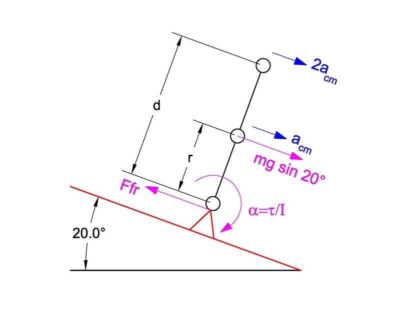

I've been studying rolling motion for a bit and I realized that there's another hole in my knowledge. Let's say that we have a wheel rolling down an inclined plane. Let's assume that the wheel accelerates down the inclined plane. We can look at the motion of the wheel as if it is moving on a flat surface but with the force of gravity in one direction accelerating the wheel (##F_g \sin{\theta}##) (keep in mind that I'm just rotating the plane here but keeping the same forces, the reason I'm doing this is to make use of the photo I have).
Now, since we have acceleration of the center of mass down the ramp, we will get the force of friction acting in such a way that it wants to oppose the motion. Looking at the point P that touches the ground we see that it accelerates with angular acceleration ##\alpha## in one direction (about the center of mass), but at the same time it gets deaccelerated by the force of kinetic friction in the other direction (assuming that the wheel is rolling with slipping now). Looking at the photo, we get that the force of kinetic friction is down the ramp (Assume in the photo that we have ##f_k## instead of ##f_s##).
Now, here's another problem. Let's say that the wheel continues to roll without slipping. In other words, the contact point P stays stationary momentarily. Since the wheel wants to accelerate in the the direction of the force ##F_g \sin{\theta}## (accelerating clockwise as shown in the picture) we will have a static friction force opposing the acceleration of the point P (counterclockwise acceleration) so again we get that the force of static friction is down the ramp.
Where am I making a mistake in reasoning?

It does not seem to be a mistake, but perhaps failing to see two different conditions:
* Any driving wheel should be under the influence of a torque, which is concentric respect to all the instantaneous axes of rotation.
In order for the driving effect to happen, at least some friction should exist between the contact point of that wheel and the surface over which is rolling.
Which direction should that reactive external force have?
* Any driven wheel should be under the influence of a force, which is acting on its CM or on its axis of free rotation.
That force should have at least a component coinciding with the forward trajectory.
Also in this case, for the rolling effect to happen, at least some friction should exist between the contact point of that wheel and the surface over which is rolling.
Heisenberg7 said:
After some time, when the object reaches the condition ##v_{cm} = r \omega## (is this guaranteed?), we will get rolling without slipping motion.
Was the wheel rolling with slipping before?

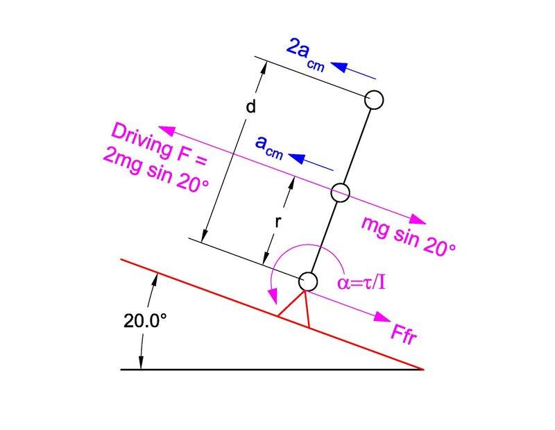

Heisenberg7 said:
Now, I am confused how friction can act in front of the wheel keeping this in mind?
It helps to be accurate about this. Friction opposes the relative motion of two surfaces in contact. Without friction, the wheel would slide down without rotating. To oppose the sliding the friction acts up the ramp.
For example, if a car uses its engine to accelerate down a slope, the point of the tyre in contact with the ground is trying to move up the slope, so the friction will act down the slope instead.

what if the force of friction can't provide the sufficient angular acceleration? Does that mean that rolling without slipping won't ever happen?
If the force of friction is ##F## then the torque is ##Fr## and ##Fr=I\alpha##.
At the same time, ##ma=mg\sin(\theta)-F##.
The condition for continuing to roll without slipping, given that it is not currently slipping, is ##a=r\alpha=Fr^2/I=g\sin(\theta)-F/m##.
So ##F=\frac{mg\sin(\theta)}{1+mr^2/I}##.
If that is greater than ##\mu_sg\cos(\theta)## then slipping will occur. Note that, assuming ##\theta## is constant, that threshold value is constant. Starting from rest, ##v=0=r\omega##: it doesn't go from slipping to not slipping; it either rolls without slipping at all or slips constantly.
The situation in which wheels do transition from slipping to not slipping is where the initial condition does not satisfy ##v=r\omega##, e.g. for a bowling ball.
