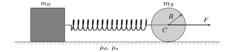

A sphere is connected via a spring, attached to its center, to a block. Initially the block and the sphere are resting on a rough plane, then a constant force F=20N is applied on the sphere. This causes the sphere to start a pure rolling motion.
I need to determine the angular velocity and how much does the spring moves from its resting point when the block starts moving. What I've difficulty with is finding this moment.
ms=3Kg ; mb= 2Kg
R= 30cm
k= 200N/m
μs= 0.5 ; μd= 0.3
Fs= -kx
ΣF= ma ; Στ= Iα
I know that the block will move only if the force that pushes him is greater than μs
Diagram of a block of mass m_B on a horizontal surface, connected by a coiled spring to a rolling sphere of mass m_S with radius R and center C, pulled right by force F; surface labeled with coefficients μ_d and μ_s.
mb g.
The only force that can act on the block is the elastic force (Fs) generated by the expansion of the spring, caused by the rolling sphere, that rolls because a force F is acting on the sphere.
Then can I say that Fs > μs mb g? I've determined this equation by analysing the forces acting on the block and found that:
Fs- Fsf ( static friction force) = 0. I've considered the right direction as positive and put the equation equal to zero because the block is not moving => it has no acceleration.
I don't know how to proceed forward from this point. How can I find the instant, when the block starts moving, if my condition is greater than something? Because all I can find now is that, assuming x is how much did the spring expanded, x >(μs mb g)/k.

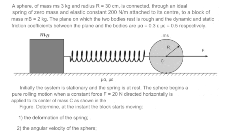

The situation you described is what its happening. I'm so sorry, I probably used wrong words to describe what the problem is asking. The question is: when the block starts moving how stretched is the spring?

Gives us the entire problem statement. Thats counter to what I thought we agreed the actual problem was...
Can you provide the calculation? I don't see that there will be a range of valuesw
Diagram of a block of mass mB on a rough plane connected by a horizontal spring to a sphere of mass ms and radius R, with center C and a horizontal force F applied at the center; friction coefficients mu_a and mu_e labelled on the plane.
Thermofox said:
Ok,
In 1) The block is static until the threshold of overcoming static friction is reached. Just before it breaks loose is the maximum deflection of the spring, the block is stationary at that point in the analysis ( i.e it begins its motion with ##v = 0 ##).
In short, the answer I was looking for was No...the "instant" the block breaks free it has no kinetic energy...
Then you can use that deflection and Work-Energy to find the angular velocity in 2).

##μ_s m_b g##= ##9,81N##
##k= 200 N/m##
=> ##x\gt \frac {\mu_s m_b g}k = 0,0491m##, hence ##x\gt 0,0491m##
I didn't found the "x" but a threshold. If x is below that than the block will not move if it is higher it will.
