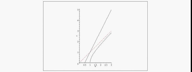

Consider the attached spacetime diagram for special relativity. The axes are coordinate axes for a particular inertial reference frame, the black curved is the worldline of observer A who undergoes constant acceleration, the red dashed line is a lightlike asymptote for A's worldline, and the straight worldline is the worldline of observer B who moves with constant velocity with respect to the inertial reference frame.
Observer A never sees B or any other observer, cross the lightlike asymptote. Do you see why? Does mean that B never crosses the red dashed line, and that events above the asymptote don't exist, never happen?

Could you explain the diagram in post #4? It seems to me if the red dashed line is the light like asymptote for A's world line, then it and A's world line should start at the same point, for instance (0,0). That way as A accelerates the slope of his world line would decrease and approach that of the red line.
"Observer A never sees B or any other observer, cross the light like asymptote. Do you see why? Does mean that B never crosses the red dashed line, and that events above the asymptote don't exist, never happen?"
Frankly no, I don't see why.
skeptic2 said:
George,
one of the observers will fall outside the light cone of the other, which means that lines connecting them would represent signals which travels faster than the speed of ligth.
This is just standard SR space time diagram procedure.

A standard SR space time diagram has time for its vertical axis labeled and space is by the horizontal axis. The world line of an object located at (0,0) and not moving in a spatial direction would continue vertically along the vertical axis. A beam of light originating at (0,0) would follow the red dashed line. Objects whose world line has a slope greater than that of the red line are traveling slower than light and those whose world line is closer to horizontal than the red line are traveling faster than light. Objects above the red line are inside the light cone and those below it are outside. Is this what you mean by a standard SR space time diagram?
The diagram that was posted however has the world line of A outside its own light cone. B starts out outside the light cone but then crosses into it. Whether A sees B is not dependent on A's light cone but on B's light cone.
malawi, do you have a different understanding of that diagram?
I agree with Skeptic2, I couldn't make heads or tails of the diagram posted but I do understand Minkowski spacetime diagrams just fine...

Yes and no.
The red dashed line is part of a light cone for an event at (0,0), but worldlines for observers do not have to go through this event. For example, if you're here on Earth and I'm near Alpha Centauri (possibly moving with respect to you) at t=0 for you, my worldline does not go through (0,0) of your coordinates. What does my worldline look like?
A lightcone for an observer always starts at an event on the observer's worldline. Take any event on A's worldline, and draw a light cone starting at this event. As t increases, A's worldline never leaves this lightcone. Take any event on B's worldline, and draw a light cone starting at this event. As t increasdes, B's worldline never leaves this light cone. The dashed line isn't part of any light cone for A, but it is part of a light cone for B, the light cone that starts at the point of intersection of the dashed line and B's worldline.
More on what A sees in another post (maybe tomorrow). Keep asking questions.
With respect, George, your posted picture serves little purpose to this thread. I would be surprised if someone claimed that events happening outside of their light cones "do not exist", which seems to be what you were trying to refute. As an aside, I think the introduction of the red dashed asymptotic line was confusing. Was it necessary for your point?
What he was attempting to get you to work out for yourself was that an accelerating observer observes an event horizon form behind him. The curved line is the accelerating observer. The straight line is an inertial observer who falls through the accelerating observer's Rindler horizon (the dashed red line). At that point, the accelerating observer is no longer within the inertial observer's future light cone at all: no signal, including light, can ever reach him from there. Just as there is a region near a black hole from which signals can never reach a different class of observers.
The Rindler horizon (the dashed red line in that diagram) is a real event horizon in the reference frame of the accelerating observer, including substantially all the properties of a Schwarzschild horizon, including the fact that in this frame, time near it dilates to such a degree that nothing is ever observed to fall through it.
