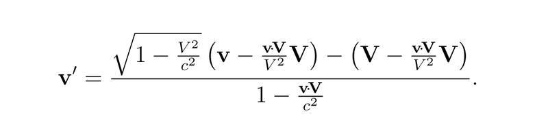

Let observer O' move respect to observer O with velocity V. Suppose, that O sees an object M moving with velocity v. A standard vector formula for velocity v' of the object M seen by observer O' is attached.
My question is the following: suppose that the velocity v and v' are given. What is the relative velocity V of the two observers?
Of course in one dimension the answer is very easy :)
Thanks for your help!

Just consider M's frame.
It is not always possible to attribute a real reference frame to M. The simplest example - M could be a particle moving with velocity of light, or a mexican wave on a stadion, which can move with arbitrary velocity v, not necessarily slower than c.
Unfortunatelly, as it usually is, a "simple" special relativity problem turns out to be too difficult for specialists in general relativity. This always made me wonder how surprisingly difficult special relativity is. And it is always so easy when it comes to storytelling about "what is time", "black holes", etc..

It still seems to me the best way is consider M's reference frame by assuming V<c then to extend the result.
To do it 'properly' you've got to use the fact that:
dx/dt = vx
dy/dt = vy
dz/dt = vz
dx'(x,t)/dt'(x,t) = v'x'
dy'/dt'(x,t) = dy/dt'(x,t) = v'y'
dz'/dt'(x,t) = dz/dt'(x,t) = v'z'
with the form of x'(x,t) and t'(x,t) being given the usual equations for a Lorentz boost.
There's the problem that if you allow supeluminal velocities you cannot get away from the fact that v or v' may be infinite.
Unfortunatelly when you consider 3 systems of coordinates, they cannot all be made "parallel" in general. So the transormations involed are not bare boosts, but space rotations also. This complicates the problem very much, because the rotations are parametrized by the velocity that you would like to find.

Thanks for the formula. There is no derivation given, but it is quite simple: one considers velocity four-vectors of B and C, calculates the product, which is invariant. Then one calculates the same product in an inertial frame attributed to B and equals the two. The formula for w^2 follows easily.
The only problem is that the formula gives only the magnitude, not the whole vector w (in my notation it was V) - so it is not the complete solution that I am looking for.
Thanks for your help anyway!
This is anyhow only the special case when one can attribute an inertial frame of reference with the observed object.

Kev, what you have shown is the first thing that comes to one's mind, but the formulas are not right. To find out, just plug them into the equation that I have given. Your formula are not solution of this equation. They only apply to v and v', not V.
The reason they are wrong is because there is an extra spatial rotation in one of the reference frames in respect to the other. And it has to be taken into the account.
Mentz114: I also realized that Baez' answer also do not apply to the velocity V - it only applies to v and v'. Also, the easies way to find out is to put it into the equation and see that it is not consistent. The same reason - an extra spatial rotation.
In conclusion: there is no formula even for the magnitude of V.
Sorry guys :)
Right now, I am just reversing the equations and it seems that it is possible to determine V this way.
