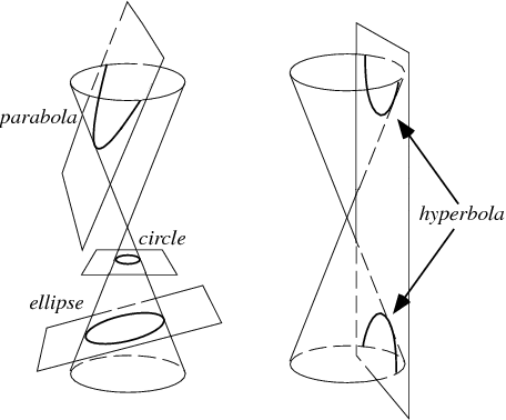

A circle is just a symmetrical special case of an ellipse, which is also a special case of a "conic section". All orbits and most non-orbit gravitational interactions form one of these shapes. Consider if we send a space probe past an object and it doesn't orbit, but just bends a little and keeps going - that's parabolic or hyperbolic.
Bit of a trick question; what shape do you get if an asteroid collides with Earth?
