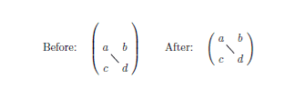

Hi,
I am trying to show the reader what is the main diagonal of a matrix, so i wrote the code using the xy-pic package, this is the code:
Code:
\begin{displaymath}
\left(
\xymatrix @=0.5pc
a \ar@{-}[dr] & b\\
c & d\\
\right)
\end{displaymath}
In the compiled file the parenthesis are taller than the matrix, and i couldn't found a solution, so i am asking help!
:smile:
Thanks,
Hi Aikon,
the problem here is the baseline of the matrix, which is not at the center. You can fix that by \vcenter:
Code:
\begin{displaymath}
\left(\vcenter{
\xymatrix @=0.5pc
a \ar@{-}[dr] & b\\
c & d\\
\right)
\end{displaymath}
On LaTeX-Community.org, it has been made similarly here: Parentheses around a sigma sum with huge subscript. There just an additional \hbox has been used within \vcenter, which an be a good idea in some cases.
Stefan
