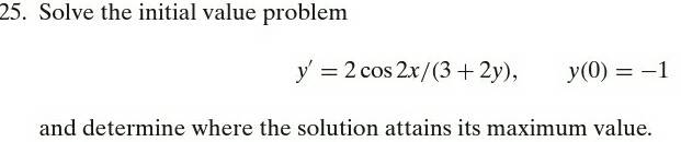

it's late so I'll just start this
\[ \dfrac{dy}{dx}=\dfrac{2\cos 2x}{3+2y} \]
so \[(3+2y) \, dy= (2\cos 2x) \, dx\]
$y^2 + 3 y= sin(2 x) + c$
You now need to use the given point to get the particular solution, and then answer the rest of the question.
(-1)^2 + 3 (-1)= sin(2 (0)) + c
1-3=1+c
-3=c
$y^2+3y=\sin 2x -3$
complete square
$y^2+3y+\dfrac{9}{4}=\sin 2x -3+\dfrac{9}{4}=\sin 2x -\dfrac{3}{4}$
$\left(y+\dfrac{3}{2}\right)^2=\sin 2x -\dfrac{3}{4}$
$y=-\dfrac{3}{2}+\sqrt{\sin 2x -\dfrac{3}{4}}$
i don't think this is headed towards the answer!
the book ans is #25
how did they get 1/4
$\sin(2\cdot 0) = 0 \implies C = -2$
Rather than complete the square (which works just fine), you can also use the quadratic formula:
$$y^2+3y-\sin(2x)-c_1=0$$
$$y(x)=\frac{-3\pm\sqrt{9+4(\sin(2x)+c_1)}}{2}$$
Using the given initial value, we find:
$$y(0)=\frac{-3\pm\sqrt{9+4c_1}}{2}=-1$$
$$-3\pm\sqrt{9+4c_1}=-2$$
We find we should take the positive root for \(y\):
$$\sqrt{9+4c_1}=1\implies c_1=-2$$
Hence:
$$y(x)=\frac{-3+\sqrt{9+4(\sin(2x)-2)}}{2}=\frac{-3+\sqrt{4\sin(2x)+1}}{2}$$
well that was very helpful
mahalo
$$y(x)=\dfrac{-3+\sqrt{9+4(\sin(2x)-2)}}{2}
=\dfrac{-3+\sqrt{4\sin(2x)+1}}{2} =-\dfrac{3}{2}+\sqrt{\sin(2x)+\dfrac{1}{4}}$$
why is $x=\dfrac{\pi}{4}$
what value of x makes sin(2x) a maximum?
Although I am normally an advocate of "completing the square" to find max or min, here I advise setting the derivative of y equal to 0. That becomes especially easy because you are given that [math]\frac{dy}{dx}= \frac{2 cos(2x)}{3+ 2y}[/math].
Setting that equal to 0 we immediately have 2 cos(2x)= 0. cos(a)= 0 for a any odd multiple of [math]\frac{\pi}{2}[/math] so [math]x= \frac{(2n+1)\pi}{4}[/math]. Check the actual values of y for [mATH]x= \frac{\pi}{4}[/math], [math]x= -\frac{\pi}{4}[/math], [math]x= \frac{3\pi}{4}[/math], etc. to determine the actual global maximum.
ok I see. $2(\pi/4)=\pi/2$
