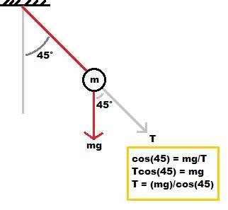

B.) Here is what I tried:
[tex]T = \frac{mg}{cos(45)}[/tex]
[tex]T = \frac{(0.12)(9.8)}{cos(45)}[/tex]
[tex]T = 1.66 N[/tex]
Which is wrong for some reason. I believe the solution to be mgsin(45) but I don't understand why?
The tension points toward the hinge. Gravity can be decomposed into components parallel with the string and perpendicular to it.
ehild

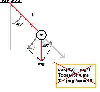

Aren't I only concerned with the red vectors in this image? Since the mass has reached it's max height and velocity/acceleration are zero at this point. I figured that there must be another vector canceling out the green mgcos(45), leaving only the red mgcos(45) to be equal to the tension as per Newton's third?
I'm still not seeing where a sine comes into play here.
You drew the tension in the wrong way in the first figure. At the top of the pendulum's trajectory, the velocity is 0, and so is the force in the direction along the string. You must balance the tension and the gravitational force (projected into that direction).
I drew it that way because it would be equal to the vector in the direction of the string that represents tension.
What I'm saying is...T and mg do not make two legs of a triangle like in that figure, I think that's why you're getting confused and writing cos(45)=mg/T or something like that.
The velocity is zero, but the acceleration is not. The component of gravity which is normal to the string accelerates the body, while the tension is equal to the parallel component of gravity (as the centripetal force is zero).
ehild
