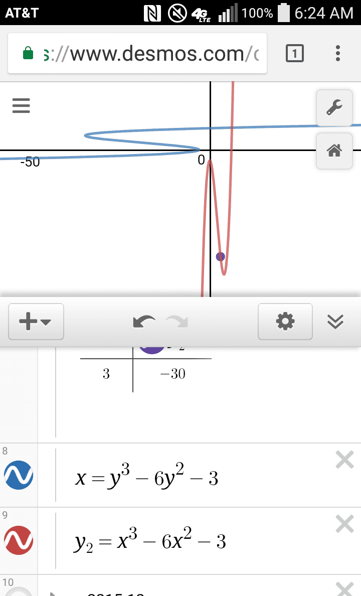

I did what I could with Desmos but
Could only do so much

Desmos allows you to plot a function and its inverse...first define the function and its domain:
$$f(x)=x^3-6x^2-3\,\{4\le x\}$$
Then define the inverse:
$$x=f(y)$$
[DESMOS=-37.36896540090182,93.61770297027579,-36.842231263227994,8.599804598412113]f\left(x\right)=x^3-6x^2-3\left\{4\le x\right\};x=f\left(y\right)[/DESMOS]
