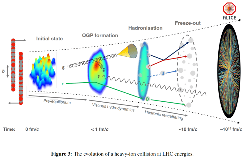

Well, here is what I would say (as a non-expert), based on the conclusions on pg. 47 of the massive (327 pages!) recent report from the ALICE collaboration at the Large Hadron Collider (https://arxiv.org/abs/2211.04384):
Head-on collisions of heavy ions in the LHC create a very short-lived quark-gluon plasma (QGP) fireball that is believed to mimic the state of the universe in the first few microseconds after the Big Bang. For the particular case of lead-lead collisions at a total center-of-mass energy ##2.76\text{ TeV}##, the fireball has an initial energy density of ##\sim12.3 \text{ GeV/fm}^{3}## and an effective temperature of ##304\pm41\text{ MeV}##, or ##\left(3.53\pm0.476\right)\times10^{12}\text{ °K}##. As the QGP fireball expands, essentially at the speed of light, its temperature rapidly drops until the fireball reaches a size on the order of ##10-13\text{ fm}##. This is the point of so-called "freeze-out", where all the quarks and gluons have recombined into hadrons (pions, protons, etc.). These hadrons are ultimately detected by the ALICE instruments monitoring the target region.

Depending on the beam energy as well as on the centrality class it's at the order of 1000-2000##\text{fm}^3##, as inferred from the statistical hadronization model, which works amazingly way to determine the particle abundancies. It's the volume at the time of thermal freeze-out, i.e., after some considerable expansion of the fireball. See, e.g.,
https://arxiv.org/abs/0812.1186
