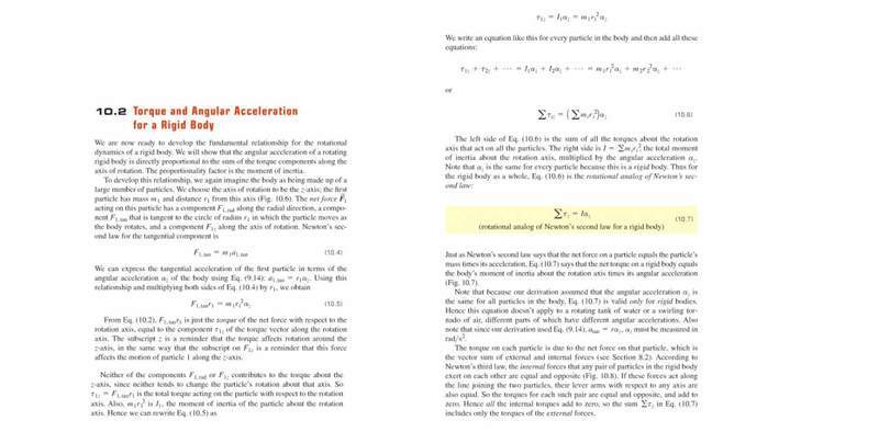

But don't you agree that for the derivation above, the logic could just as well be followed if you multiplied by ri2 as if you multiplied by ri as you are to do. I will show you the specific derivation and you can tell me if it would violate any of the steps if you did that.
My problem is not that I don't understand the correct equations. I know everything about conservation of energy, torques, conservation of angular momentum etc. I'm just curious if that system of equations are the only ones that make up a system that can describe the world mathematically.
  • Two-page textbook spread on torque and angular acceleration for a rigid body, showing numbered equations 10.4 through 10.8 and the rotational analog of Newton's second law, sum of torques equals I alpha.
The equation [itex]\sum \tau = I\alpha[/itex] is a consequence of the way Torque and Moment of Inertia are defined. If you redefine Torque as something else, and don't redefine Moment of Inertia, why would you expect the equation to still hold true?
Well would my defining of the new quantity Ʃmiri3 not make up for that problem?
But maybe all these speculations are lunatic. After all the definition of torque is the only thing that doesn't violate the fact that the work done by the rotating force should equal the change in kinetic energy:
Frdθ = ½I(ωf2-ωi2) = Iαdθ
Fr = Iα
So I guess that somehow establishes a unique and crucial link between translation and rotation.
But it still bothers me that I always in derivations find quantities that would fit just as well into the logic and can't explain why they aren't instead used.
Some of it is due to the usefulness of conserved quantities when it comes to analyzing physical systems and predicting their behaviour. For example, momentum is always conserved as it is conventionally defined, and conservation of momentum is frequently used to analyze physical systems (especially collisions!), so defining it in some other way would probably be less useful. Since conserved quantities are so useful, defining other quantities which can be easily related to conserved quantities can also be useful. Take, for example, the relationship between torque and angular momentum. Angular momentum as conventionally defined is conserved when there are no external forces present (and changing its definition to include an extra factor of |r| would change that!), so defining torque as the time rate of change of angular momentum makes it useful.
Some of it just boils down to convention, which is useful for allowing physicists to communicate effectively with each other.
