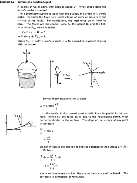

Text problem: A bucket of water spins with angular speed ω. What shape does the water's surface assume?
If I consider an arc shaped element of the liquid, then the physical forces acting on it are 4 different tensions , normal force and gravitational force on it. Two of the tensions would be acting along tangential direction (opposite to each other) and the other two along radial direction(opposite to each other) .
Now, in steady state, normal force and gravitational force cancels each other.
I assume that in dynamic state, too, normal force and gravitational force cancel each other.
Assuming tangential acceleration to be 0, the two opposite tensions along tangential direction cancel each other.
Now, wrt. inertial frame , the two opposite radial tensions provide centripetal acceleration. But then how to decide the shape?

Well, it is an example given in the book which I want to solve without looking at the solution in the book.
So, if you feel that the information given in the question is not sufficient, I am attaching the example so that you can guide me.
  • Textbook page, Example 8.6 Surface of a Rotating Liquid, with a bucket of water spinning, force diagrams for the liquid surface, and the derivation giving z = (1/2g)ω²r² as a paraboloid.

I completely disagree with this solution in your book. Certainly, the normal load at the free surface is constant, and equal to the atmospheric pressure outside the fluid (assuming negligible surface tension effects, which you are clearly expected to assume). The solution in your book is totally bogus.
Here's how I would solve this problem. As indicated in the problem description, z is the elevation of the free surface above the lowest point of the free surface at the center of the bucket. Let h be the depth below this location. I am going to focus on a fluid Free Body situated between depth h and depth ##h+\Delta h##, between angular locations ##\theta## and ##\theta+\Delta \theta##, and radial locations r and ##r+\Delta r##. So the volume of this free body is ##(r\Delta \theta)(\Delta r)(\Delta h)##. I am going to do a radial force balance on this free body. The fluid pressure at radial location r and depth h is p(r,h). The pressure force acting on the free body at the radial location r is ##[pr\Delta \theta \Delta h]_{r}\mathbf{i}_r##, where ##\mathbf{i}_r## is the unit vector in the radial direction. The pressure force acting on the free body at radial location ##(r+\Delta r)## is ##[-pr\Delta \theta \Delta h]_{r+\Delta r}\mathbf{i}_r##. The pressure force acting on the free body at angular locations ##\theta## and ##(\theta+\Delta \theta)## are ##[p\Delta r \Delta h \mathbf{i_{\theta}}]_{\theta}## and ##[-p\Delta r \Delta h \mathbf{i_{\theta}}]_{\theta+\Delta \theta}##, respectively.
If we sum these forces and set them equal to the mass times acceleration of the free body, we obtain:
$$[pr\Delta \theta \Delta h]_{r}\mathbf{i}_r-[pr\Delta \theta \Delta h]_{r+\Delta r}\mathbf{i}_r+[p\Delta r \Delta h \mathbf{i_{\theta}}]_{\theta}-[p\Delta r \Delta h \mathbf{i_{\theta}}]_{\theta+\Delta \theta}=-\rho (r\Delta \theta)(\Delta r)(\Delta h)\omega^2 r\mathbf{i}_r$$If we divide this equation by ##(\Delta h)(\Delta r)(\Delta \theta)## and take the limit as ##\Delta r## and ##\Delta \theta##, we obtain:
$$\frac{\partial (pr)}{\partial r}\mathbf{i}_r+p\frac{\partial \mathbf{i}_{\theta}}{\partial \theta}=\rho \omega^2 r^2\mathbf{i}_r\tag{1}$$
We know that the derivative of the unit vector in the theta direction with respect to theta is given by:
$$\frac{\partial \mathbf{i}_{\theta}}{\partial\theta}=-\mathbf{i}_r\tag{2}$$
If we substitute Eqn. 2 into Eqn. 1, we obtain:
$$\frac{\partial p}{\partial r}=\rho \omega^2 r\tag{3}$$
Integrating Eqn. 3 between r = 0 and r yields: $$p(r,h)-p(0,h)=\frac{1}{2}\rho \omega^2 r^2\tag{4}$$
I'm going to stop here for now and give you a chance to digest what I have written.

## \vec F_{con} ## is comprised of pressure forces on your element of volume. There are hydrostatic pressure forces on the top and bottom (in the z direction) and, in the r and ##\theta## directions, there are the pressure forces that I included in post #6.
In your equation,
## \vec F_{con} + m \vec g = m\{ \left ( \ddot r - r \dot {\theta}^2\right ) ~\hat r+ \left ( 2 \dot r \dot \theta +r \ddot \theta \right ) ~\hat \theta\} +\ddot z \hat z##, since r and z are not changing with time and the angular velocity is constant, the right hand side reduces to ##- mr \dot {\theta}^2\hat{r}##. The mass m is expressed in terms of the density and volume of the element, as in my post #6. The gravitational term is in the z direction, and is equal to ##-mg\hat{z}##.
The net result of all this is that, when your force balance equation here is dotted with ##\hat{r}##, you obtain Eqn. 3 from my post #6.
Incidentally, it doesn't matter if the water is rigid. In this problem, it is rotating as a rigid body, and, more generally, even a liquid satisfies Newton's 2nd law, at least on a differential basis.

When the fluid is rotating about the axis, from the perspective of an observer in the rotating frame of reference, the apparent centrifugal force is equivalent to gravitation in the radial direction (i.e., it appears to be a body force). So it's virtually analogous to vertical hydrostatic force, except that the gravitational acceleration radially is dependent on radial location.
But, this is wrt rotating frame. I am solving it in an inertial frame.
It doesn't matter whether you are solving it in an inertial frame or in a rotation frame. All that happens is the the "ma" term gets moved to the other side of the equation with a change in sign. The final answer comes out the same either way.
The fluid is rotating, and the parcels of liquid have to travel in circles about the axis, so they have to be accelerated in the negative radial direction (as reckoned from an inertial frame of reference). So the wall must presses inward on the parcels further out, and the parcels further out must press inward on those closer to the axis. This is how the radial pressure gradient is established.

In the link ,it is said that the ##\vec F_{con} ## is perpendicular to the surface.
##\vec F_{con} ## cancels weight and provides centripetal acceleration. For, providing centripetal acceleration it has to have a component equal to ## mr \dot {\theta}^2## in -ve radial direction and ## -\hat r## lies in the surface. So, how can it be normal to the surface?
## -\hat r## is horizontal.
