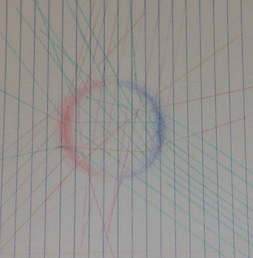

So I approximated some geodesic around a positive and negative energy densities and I came up with the conclusion that in front of you you'd see a fisheye view of the universe, like looking out through a peephole in a door. Behind you, you'd see a reverse fisheye view, sort of like trying to look through a peephole backwards. However, both it wouldn't be clear, the entire thing would be out of focus unless you were in an exact sweet spot.
Does this sound right? In my image, the blue is positive energy density and the red is negative energy density. There are three stars, one green, pink, and brown, the brown on is behind the spacecraft .

I thought the idea behind the Alcubierre drive was that the ship is not moving through the space inside of the bubble, and that space outside of the bubble (and the light traveling through it) was moved around the outside of the bubble.
How big is your bubble? As long as you're bending space, there's no reason to make the outside bigger than the inside, and this could help with that annoying energy flux.
