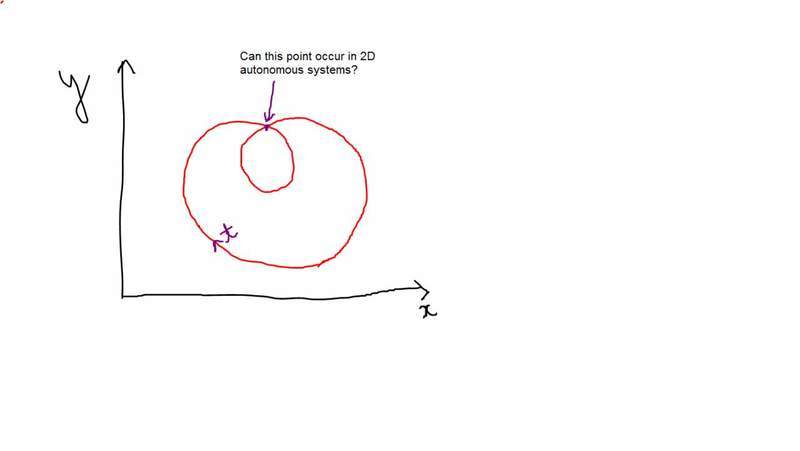

could you give an example where the Lipschitz condition fails,like when there is a periodic forcing function?
I'm thinking the Lipschitz condition would fail for a non-autonomous differential system because period-2 orbits exist for 2D non-autonomous continuous dynamical systems,which means the uniqueness condition that the Lipschitz criterion so vehemently describes in DE does not hold for non-auto systems.
How does one explain this mathematically? Intuitively, I could say uniqueness of solution curve exists because of phase change due to the periodic forcing function. But,which theorem states this mathematically?
for example,take the non-autonomous differential system:
$$\frac{\mathrm{dx} }{\mathrm{d} t}=x^3 + aSin(\omega t)$$
$$|f(t,u)-f(t,v))|\leq L|u-v|$$
$$u^3 - aSin(\omega t)-v^3-aSin(\omega t)$$
$$|u^2+uv+v^2||u-v|\Rightarrow |u^2+uv+v^2|\leq L$$

But HallsofIvy, in the diagram I have attached,I show a period-2 orbit in a 2D continuous phase space. Notice that the orbit loops onto itself. This kind-of orbit cannot exist in autonomous systems because there will be no uniqueness as time progresses. So,my question is whether such a orbit exists in non-autonomous systems? I can intuitively guess that they do exist in N.A systems because there will be a phase change in the solution and so one can say that the solution curve is unique when it loops onto itself. How can I explain this uniqueness in N.A systems using Lipschitz condition? I wrote an example of Lipschitz uniqueness for non-autonomous systems and the coefficient is bounded.Does this suggest something?
