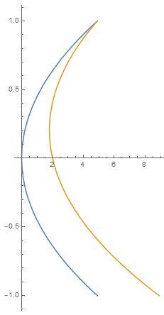

In an inertial frame the ground (blue line) is accelerating upwards (which I have pointing to the right on this spacetime diagram). When you (orange line) jump your worldline departs from the ground's worldline. You are not accelerating while in the air, so your worldline is straight. Eventually it re-intersects with the ground's worldline and you land. From that point on you are accelerating with the ground.
If you are not familiar with spacetime diagrams, they are just position vs time diagrams. Traditionally time is put on the vertical axis and space is put on the horizontal axis. This may be a little confusing at first, but like any convention you can get used to it.
This graph is the most helpful for me understanding and I see we are assuming a grid for a window of the acceleration of the ground and the vertical axis representing time , hence why the blue line is sloped parabolic as the 9.8 meters per second squared that we perceive as free fall but in Einstein GR is the ground motion up …. We are in our geodesic for the entire time we aren’t touching the ground, and removing air resistance from the equation, our velocity from the energy we use to move “up” is our new inertial frame that starts immediately after the new energy release is done and we are off the floor.
Yes, the horizontally right direction in the graph corresponds to the vertically up direction physically. That is just due to the convention of using the vertically up direction in the graph to correspond to the future time direction physically.
Yes, that is the straight segment of the orange graph.

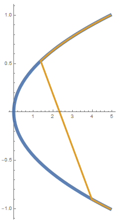

ESponge2000 said:
Can this be drawn to a diagram?
Sure. Again, the ground is blue. The orange is a skydiver that is at a constant velocity relative to the ground. They are both accelerating "upward" at ##g##

ESponge2000 said:
For the plane the lift is actually the tilt of the wings the shape of the air resistance, so it’s an engineering maneuver that allows for having a plane jet go level horizontal and not have any effects of the geodesic that aren’t offset
A plane traveling in level flight over the Earth's surface is not traveling on a geodesic.
