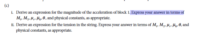

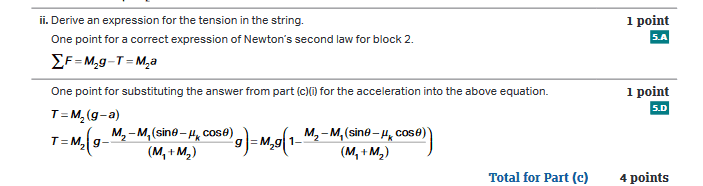

Also something to add that further supports the notation against needing to use all variables, in another college board question they had an answer not use all the terms listed.
Question:
Answer to c ii
source: https://apcentral.collegeboard.org/...-guidelines.pdf?course=ap-physics-c-mechanics
The problem statement does say "as appropriate" which I take to mean you should use the ones you need. Even if that phrase weren't included, I don't think you should feel compelled to use all of the variables listed.
I'm not sure I understand your question. Some expressions will involve static friction, some kinetic friction, some may involve both. I don't think the question setter needs to tell you precisely which ones apply in every formula. Sometimes, for example, the mass may not appear in a final equation. It's up to you to work out whether this is the case.

The question was just what "in terms of" meant as I originally thought it strictly meant you had to use all the variables listed. Thank you guys for sorting that out for me.
