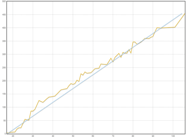

I'm using a Javascript plugin to do the linear regression.I don't care if it's accurate yet, just getting a line that approximates the data.
This is the result I'm getting:
  • intercept:-67.21099273332828
  • r2:0.986173087681175
  • slope:4.988511467716297
I assume that means:
  • first data point is at -67,0
  • each datapoint index i on the x-axis is .98 of a tick (i.e. for i =10, x = 9.8)
  • a given datapoint's
    • x value will be r2 * i
    • y value will be at slope * r2 * i
(I'm not sure why the intercept is negative but doesn't render as negative in the chart.)
So, if I am to render the extrapolation line, I need to provide two data points.
One will be [-67,0] and the other will be [iΩ, y]
where y is iΩ * slope

I don't know the JS plugin you use, but the plotted line for observations made me curious: How do you handle plates not seen yet?
Because your chart doesn't start at plate 0. It starts at ~18. If you would start at zero the fit would show negative values.
R2 is a measure of the fit quality, 1 is perfect (everything is on a straight line). It doesn't imply any step size anywhere.
I used flot.js to do the rendering (grr. It only supports jQuery. I'm using angular 1.5, so I have to load jQuery as well, which is counter-indicated by angular.)
For the actual linear regression calc, I just stole the function from a stack overflow thread. I'll upload latest, so's'n you can look in the app.js file. (Or I'll just paste it below.)
You mean like CCK and CDZ, whose time frames have passed? Or do you mean like CZZ, which hasn't been released yet?
Of course you mean the former. I filtered out null dates as well as 'unreliable' and 'unused'.
Now that I think about it though, I shouldn't filter out null dates. They still have a valid x , even if their y is not known.No. Even that's not true...
In the case of CDZ, it was surely released, I just never spotted it. So, upon release, 21,000 plates were issued: CDZA 000 through CDZZ 999.
But, in the case of CCK, there would (probably) be no such release. CCJZ 999 would be immediately followed by CCLA 000.
Shoot that is an unresolvable ambiguity in the data - an intractible problem. I cannot know if a given sequence added 21,000 plates to the road or if it added zero.
But I didn't start at -67. :oops:
Ah. Then I'm using it wrong. It sounds like I shouldn't use it at all in the x,y calcs.

DaveC426913 said:
Yeah. But there still needs to be a placeholder for it. Not sure what one does here. Derive a y value (by interpolation) that has no effect on the linear regression?
That'd be weird. I'd have to revisit that data point after I know its predecessor and its successor to derive a median value. Even that would only approximate the true slope.
Derp! Hit me while I was driving.
Because this dataset is not represented by a scatterplot!
It's just a plain old plot.
The x-axis data values are not recorded values; they are indexed - they're integers.
And that's how you get placeholders. Every x-value is represented - it's just that some don't have a y value.
'unused' records do not get in the chart. (because CBH is followed immediately by CBJ). Everything else does. (Though null dates still have ambiguous status.)
Actually, in theory the chart should clear up the ambiguity! I should be able to see if a given plate was passed over, or if it added 21,000 cars to the road while I wasn't looking.
Every good fitting tool will accept data points with x/y values, just don't give one with the missing data.
DaveC426913 said:
Forgive my obtuseness. How?
CAA was introduced about 70 days before you started looking for plates. If you choose the date 0 to be the first observation, then the introduction of CAA will get a negative date value. I don't see what would be surprising about this.
In principle this should be possible, but I don't know if the observations are good (early) enough to do this confidently.
mfb said:
Every good fitting tool will accept data points with x/y values, just don't give one with the missing data..
Right but that plate does exist on the x-axis.
If I were to simply skip it, then the slope would jump vertically and be inaccurate.
Right. Of course. I was looking in the raw data, not the extrapolated line.
Sure. Your dataset has "plate 54: date, plate 55: date, plate 57: date, plate 58: date, ...".
