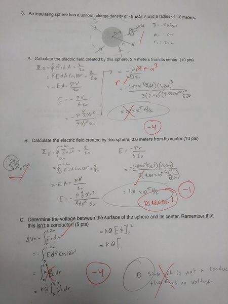

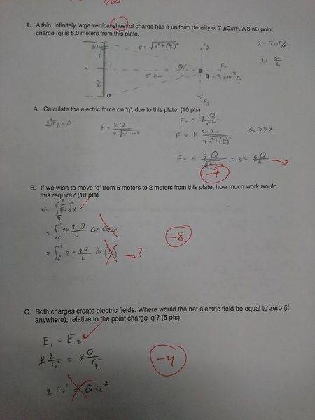

I went over the exam and I think I am not understanding the material on a deeper level. I have seen the concepts in specific scenarios and know how to solve them that way but given a new scenario where there are mixed concepts I am getting confused. Things like what values to plug in for E given the information I have. If my mind is stuck on Coulomb's Law, my brain is even looking at Gauss' Law. If it's not unethical for me to do, I can upload my exam so you can see the specific exam questions.
Just upload the 1-2 hardest questions please. Uploading a whole exam would be a bit much...
Here they are. The full exam was an hour long with 4 questions with 3 parts each. Each problem was worth 25 points. I understand why I did the first one wrong. I forgot to use Gauss' law instead of coulomb's law. This problem is where the bulk of the points were lost. Assuming I remembered the correct method and didn't make any mistakes those 19 points would have bumped me up to an A.
In the question I didn't state a symmetry argument (E=E(r)r^) and I think I am mixed up on which radius to use in what spot on part a (this was not just a small mistake made, I legitimately don't remember which is which.) The last part on that one, I just couldn't come to an equation that wouldn't give me an undefined value so I threw out a statement that I figured was wrong (it's better to write something than nothing right?) but just didn't know where to go.

Sarcasm noted. But in fairness, posting so many problems without typing your work into the forum makes it hard to deal with. The images are not very clear, so we would need to zoom in and try to figure out what the problem is with each.
I'll go ahead and close this thread. Please post one question at a time in the Homework Help forums and post the question and your work into the forum using the template. That will make it a lot easier for us to give you help with these questions. Thanks.
