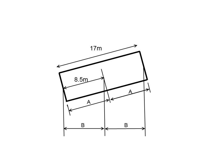

I am basically designing a rotary drum dryer and need to know the positions of the bearings for the dryer to be stable.
The drum is of length 17 m with diameter 3.24 m, inclined at 2° rotating at 3.24 rpm. I need to find the distance X and OY. (Given that Y passes through the center of mass) Weight of the drum =280 kN

I am trying to solve this using moments. But I am stuck with finding the centre of mass of the inclined cylinder.
According to me (and after reading alignments of rotary drum, they did not take into consideration the inclination), X can be found by : (17/2)/2 =4.25m (Is that possible?)
Finding the centre of mass of an inclined cylinder is quite trivial. So I think you might be asking the wrong question?
Lets say that the drum is uniform and the centre of mass is mid way between the ends when viewed horizontally (eg 17/2 = 8.5m from one end). Then when inclined it will still be mid way between the ends when inclined. See diagram.
A = 0.5*17*Cos(0) = 8.5m
B = 0.5*17*Cos(2) = 8.4948m
Similarly if the centre of mass is say 1/3rd of the way from one end.
