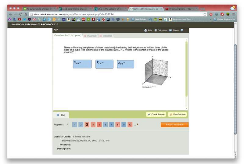

Where is the mass of the joined squares?

I did Xcm=Lx/(xyz) Ycm=Ly/(xyz) Zcm=Lz/(xyz)
I modeled it from the equation CM=(mx+...)/M

Go back a bit - can you find the centre of masses of the individual plates?
L*L if your talking about one of the faces.
That's not the COM of the face.
Have a look at the bottom face - since it is a uniform square, then the COM must be at its geometric centre. The same for the other 2 faces.
Then replace each of the faces by a single particle at their COM - you can then combine these to get the overall COM

Hint : The COM of the bottom piece is the point ( L/2, L/2, 0 )
so the xz piece would be (L/2 0 L/2)
and the xy piece would be (0 L/2 L/2)

The second one here is the yz piece.
So, now just regard the mass of each piece as being concentrated at its COM and you end up with a system of 3 particles.
Then use the definition of the COM to find the overall COM of these 3 particles.

Hint : in the xy plane, you can replace the piece of mass m with a particle of mass m at the point (L/2, L/2, 0).
Do the same for the other 2 pieces.

What is the definition of centre of mass?
center of mass is where the weighted position vectors to point sum is zero
So, the CM is given by
[tex]\mathbf r_{CM} =\frac{1}{M} \sum m_i \mathbf r_i[/tex]
You have the position vectors ri for each of the 3 parts. Call the mass of each piece m and then apply the above equation.
