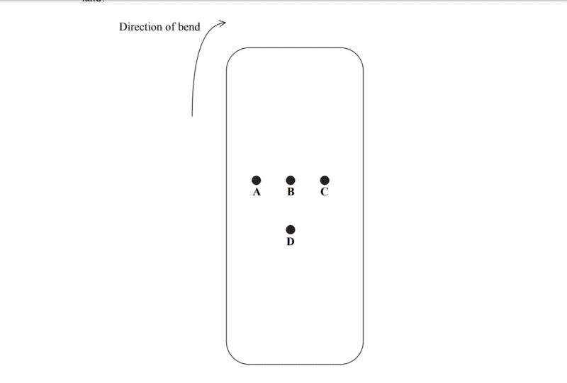

A person is standing at point C in a train carriage travelling round a sharp bend to the right. The person jumps up. Nearest which marked point is the person most likely to land?
F=ma
I need help with the following question please.
I understand that the person carries on in straight line while is jumping. This is because there is no horizontal force acting on him so based on Newton's first law of motion he continues with the previous speed.
I know he should land on A or B but I'm not sure why B cannot be the answer.
here is the question:
A person is standing at point C in a train carriage traveling round a sharp bend to the right. The person jumps up. Nearest which marked point is the person most likely to land?
I have attached the picture for you to see.

The question says ‘Nearest which marked point...’. So there is no reason to believe the person should land exactly on any of the marked points.
The question says ‘most likely to land’ which implies different answers may be feasible but with different probabilities. That’s very unsatisfactory in my view.
It is not clear what ‘sharp bend’ implies. Does this mean the bend is completed while the person is still in the air?
Note you wrote “he continues with the previous speed“.
This should be “he continues with the previous velocity”.
EDIT: I should have said: "he continues with the horizontal component of velocity unchanged.
I can’t see any way to reach a sensible answer. But that could just be me. I’d be interested to read what others say.
Edit: Note, your title "Statics & Resolving Forces" is completely inappropriate!

If you are external observer on the ground, you will see this:
1. From Newton's 1st law, the person's horizontal velocity component while in the air will be constant; it is the same as at the moment he jumped up, i.e equal to the carriage's initial horizontal velocity. So the person will behave as a simple projectile, heading in the +y direction.
2. While the person is in the air, the centre of the carriage will have moved in the +y and +x directions. And the carriage's axis will have rotated clockwise 90º (assuming that's what is mean by 'travelling round a sharp bend to the right').
So, as far as I can see, the person cannot possibly land on point C.

Hi . Thank you. I know the answer is A but I cannot explain why .

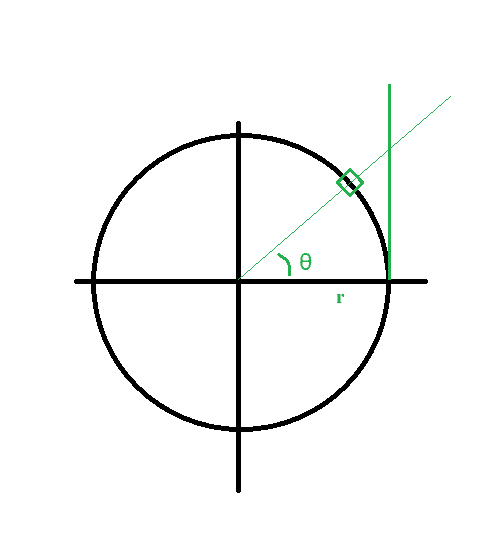

I would draw this out, a bit exaggerated. Considering a sharp turn, I think that would imply a longer travel distance (i.e. increased speed) for both points A and B...
Are you sure D is out?

try drawing it like this. (left turn instead of right...)
The distance traveled along the vertical green line should be the same length as a given arc segment, if the speed is constant.

A poorly written question will cause more confusion. If the jump is slight then C is the answer. If the turn and the centrifugal force is slight(what is the definition of sharp) then the answer is still C. However, if the speed of the train is fast and the turn truly sharp then depending on those factors(forces) you may land on any of them.
The poster stated they knew the answer was A, but how? What forces was provided with the question to arrive at that fact?

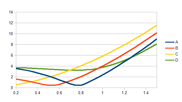

It is not about forces, other than that the jumper continues with the same horizontal velocity because there is no horizontal force on her.
We can assume that the speed is also constant for the centre of the carriage. Since it is a train compartment, not a coach, the centre of curvature (once both bogeys are in the turn) will be on the left-to-right midline.
It is reasonable to assume a substantial turn, at least 30 degrees.
I took the centre of the turn as the origin, at distance r to the right of the centre of the carriage. Based on the diagram, I set the initial coordinates of A, B, C, D as (-r-2,1), (-r,1), (-r+2,1), (-r,-2).
With a turn through ##\theta##, the final position of the person is ##(-r+2,1+r\theta)##.
With r=10 I found:
Theta=pi/6, B is nearest (very close)
Theta=pi/4, A is nearest (very close)
Theta=pi/3, A is nearest
Theta=pi/2, D is nearest
Seems like this is a BAAD question.
Edit: to confirm @Steve4Physics' point in post ##11, C is nearest for theta less than about 19 degrees.

With the same settings as in post #14, here are the distances from the landing point to the labelled points (y) as a function of theta (x, radians):

View attachment 282908The distance traveled along the vertical green line should be the same length as a given arc segment, if the speed is constant.
I have actually done this and I thought the person lands on the intersection point since the person is going straight and with the velocity of the bus before it started turning right.

As my graph in post #16 shows, all four are possible, depending on the exact parameters.
oh yes , I thought about it again and I think you are right. all of them are possible.
