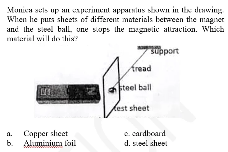

The answer key is (a) but I don't understand why. Option (a), (b), (c) are all non - magnetic material and (d) is magnetic material. Why (a) can stop the attraction while others can't?
Thanks
Can you post a link to the online question? Obviously any magnetic shielding effect would require a ferrous material.

Sorry I got the question in form of printed paper so I don't have the link. I think the answer is (d) but I am not sure how the distribution (shape) of magnetic field inside the steel sheet would be. Is there any possibility some part of the magnetic field is redistributed by the steel sheet towards the steel ball so it would still be attracted?
IMO the answer-key is wrong and the correct answer is d - the steel sheet.
Steel* has a high magnetic permeability. A large steel sheet will concentrate and redirect the field lines like this:
It’s worth noting that this wouldn’t apply with a narrow piece of steel. In that case, the local affect on the field would be more like this:
The steel would locally propagate the field in its original direction.

I think you are right, and the correct answer is d.
A copper shield can be better than a steel shield against a high-frequency magnetic field, but based on the picture from the original post, there is only a static magnetic field.

Hello , so copper is the only material stated that is diamagnetic. Diamagnetism means that the material has negative magnetic susceptibility (it doesn't allow magnetic streamlines to pass through the material) which means that it repels the magnetic field. Cardboard has no effect in repelling nor steel or alumium because both of these metals are paramagnetic ,which means they allow the streamlines to pass through thus the magnetic field. For this kind of magnetism problems I would like to refer to you books of Solid State Physics.
That's incorrect.
The ability of a material to shield and channel magnetic fields is measured by its relative-permeability ##\mu_R\,##, which takes the value of ##1## in vacuum. The weak diamagnetism of copper gives it a permeability of ##\mu^\text{Cu}_R=0.999994##, which is so close to vacuum that its magnetic shielding effectiveness is negligible. In contrast, ordinary ferromagnetic carbon steel is much more effective than copper with ##\mu^\text{CS}_R=100##. Indeed, some specialty steels have permeability values as high as ##\mu_R=38000##! (See https://en.wikipedia.org/wiki/Permeability_(electromagnetism).)
So the proper answer to the OP's original question is clearly: d. steel sheet.
