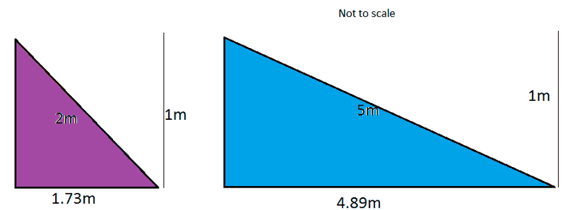

A ramp is shown in the picture.Which ramp is easier to rise an object of mass 2kg up?and why?
W=FS
The second ramp.The work done in rising the mass against gravity is same in the two ramps.That is
W=200N*1 = 200J
But rising in the second ramp,the mass has to move more distance.
200J=5*F So less force is needed F=40N
The first ramp
200J=2*F F=100N
In the second ramp one has to use less force to move it up so it is easier.
My question is:If he uses 40N against gravity(200N),Why doesn't the mass accelerate down?

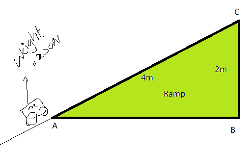

This question was based on a question on my textbook which is as follows:
(In the picture)
A trolley weights 500N.What force F is needed to pull it up From A to C,assuming that there is no friction?
Answer(Given in the textbook itself)
To raise the trolley vertically from B to C,a force of 500N is needed.
So:Work done=Force x distance moved= 500N x 2m =1000J
Treating the ramp as a ligting machine,this is its useful work output.
If the trolley is pulled up the ramp from A to C.
Work done= Force X distance moved = F X 4m=1000J
This is work output
As there is no friction ; Useful work output=work input
So,leaving out the units for simplicity:F x 4=1000
This gives F= 250N,so the force needed to pull the trolley is 250N.
That answer did not refer to horizontal works done.It merely relied on vertical work.This is similar to my question><

What's the component of gravity acting down the incline?

No. 200 N is the total gravitational force, which acts downward. You need the component acting down the incline (parallel to its surface).

Not directly, but you can figure it out. In fact, that's what you did, in effect.
Without the benefit of a ramp, you must exert the full weight of 200 N upward to lift the mass 1 meter.
But with a ramp, the force you have to exert needs only to balance the component of the weight acting down the ramp. (The normal force of the ramp surface does the rest.) For the first ramp, that component is 100 N. For the second, it's 40 N. Of course, the lower the force you have to exert, the longer a distance you need to push the mass to get it to the same height. The work done is the same.

The normal force "cancels" the component of gravity perpendicular to the surface, but that component is not 160 N (it's about 196 N). All that's left is the component parallel to the surface, which is what you have to exert to push it up the ramp. That parallel component is 40 N.

Not exactly sure what you're asking. Since we presume that the mass is being raised at some constant speed, the net force on it must be zero. You are exerting a force of 40 N at an angle; the vertical component of your force is only about 8 N. The ramp surface exerts the other 192 N of vertical force needed to support the weight.

I would not put it that way. I'd say, as I already have, that you are exerting a force equal to the component of gravity acting down the ramp, which equals 40 N. (The ramp takes care of the component of gravity acting perpendicular to the ramp.)
